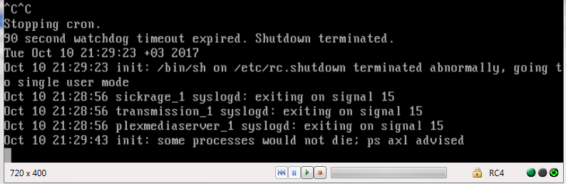

I received an e-mail from my FreeNAS installation, which says
The volume incihdd (ZFS) state is UNAVAIL: One or more devices are faulted in response to IO failures.
When I connected to console to check it, it seems that drive has disconnected and reconnected itself.
(console screenshot: https://www.dropbox.com/s/a9y4szvuwl4h7h6/incihdd.png?dl=0)
This drive has only FreeNAS system dataset in it. My boot and data drives are different.
I can't get a shell, asks for username and password then hangs. I can switch consoles with ALT+F2 F3 etc. but same applies. No webgui or shares available also.
  1. Is there a way to reboot the machine gracefully (other than pulling the plug)
  2. I'm assuming that drive is died even it reconnected itself. What is the procedure for replacing drives that contains system dataset?
This is the second time having problems with system dataset. First one caused by using an USB drive, since then I'm using a standard 2.5" HDD.

My server is still running, but I can't gracefully shut it down because I can't get a shell/webgui/etc. Console session (with IPMI - hp iLO) and SSH attempts will ask for username and password, I enter them, then it hangs. I can switch consoles (on IPMI) with ALT+F2 F3 etc. but end result is same. It still respond to pings, accepts SSH connections but hangs on login. I'm trying to find a way to poweroff/reboot this to ensure my filesystems are synced and reducing risks of ZFS corrupting. If there isn't another way, I'll hard reset it forcedly.

Ctrl-Alt-Del?
Now it hangs there. Don't allow any input, ALT+F1-2-3 is stopped working (probably because single user mode?) and SSH attempts are now refused.
Appropriate timing for saying "it's dead Jim" ? Somehow the USB subsystem is working, when I reconnect to remote console, the usual "virtual keyboard connected" messages still appearing.
