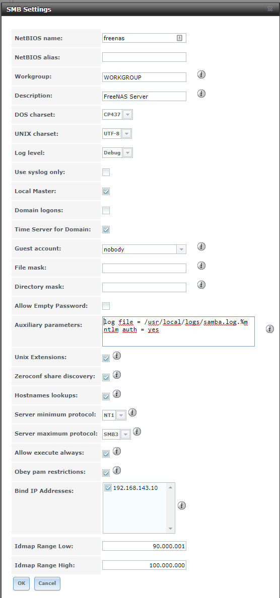

- Found out that the camera's best protocol for authentication is NTLMv1 (considered unsafe since 2003 I belive)
- I just needed to add "ntlm auth = yes" to the "Auxiliary parameters:" in the SMB Service
- (Its neither safe nor recommended but I want to try it anyways)

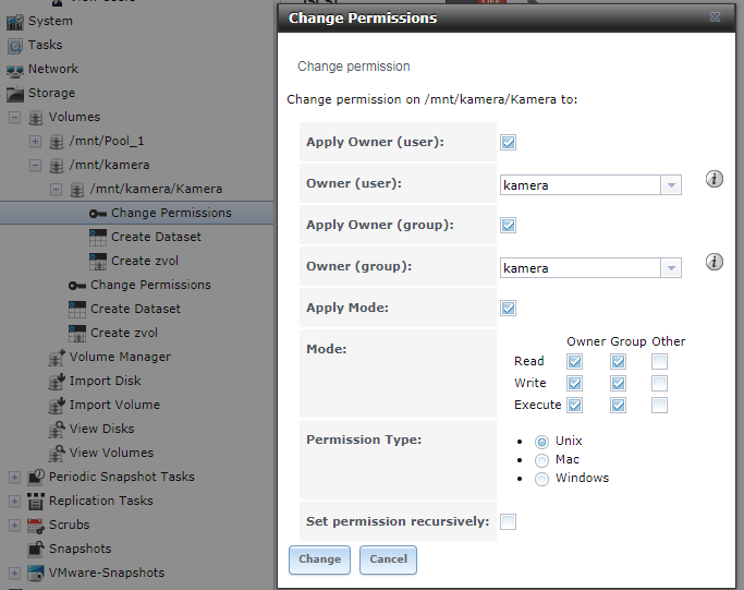

- FreeNAS dataset settings
- FreeNAS SMB service settings
