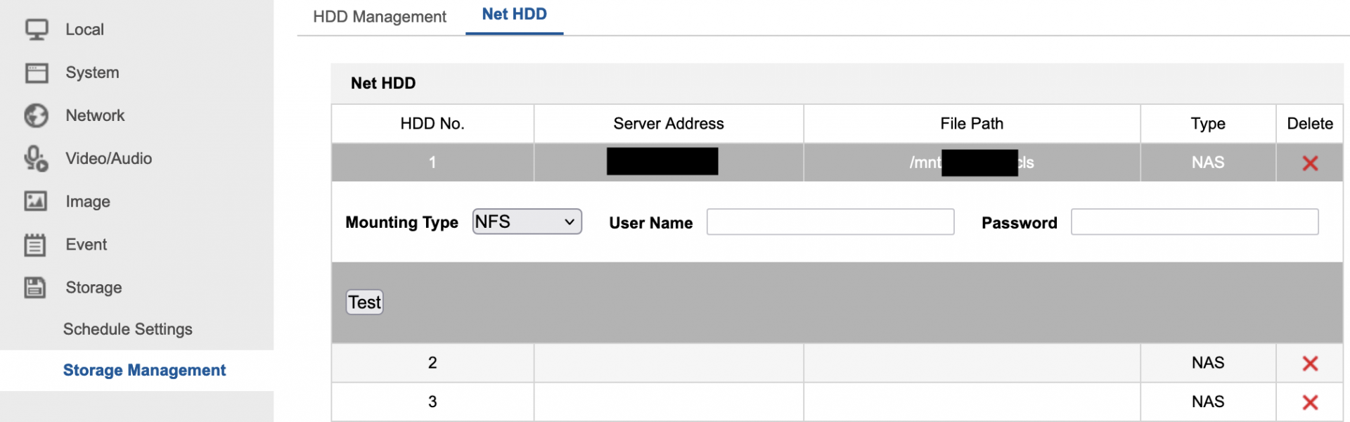

is this the screen you're working in?
What's currently there works for me.

Yes here I configure also. Same interface. But to my camera for NFS is not allowing me to add username and password
9,703
And you should not do that... the NFSv3 protocol doesn't require a user for the mount. You can see in my screenshot, those are blank and it works fine.
9,703
I am using the root:wheel combination for the mapall user details, so those are fine too.
