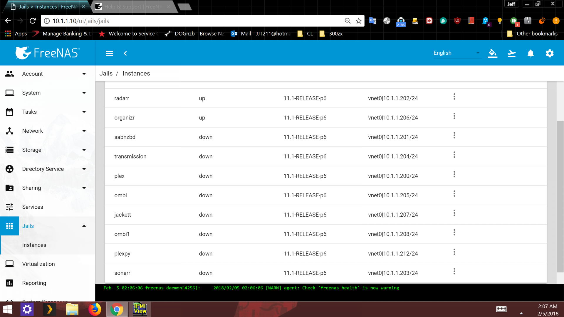

I just made the switch over to iocage a few days ago and everything was working fine until I got a warning message that one of my boot usb drives went down. I tried rebooting server and it would not reboot until I removed the faulty usb drive. Once I removed faulty drive, all appeared fine as I booted up. But now I noticed that 2 of my 9 jails will not start. Could it be related to server being in a degraded state? Is this normal? I seem to recall having a usb boot drive fail before and I didnt miss a beat. Whats the deal now?
Also, I think may be worth mentioning is I also have the ZFS pool upgrade pending warning. Could this be related?

OK, maybe im missing something. How do I navigate to that directory? When im in the shell, I type in "ls" and I do not get a var directory. I must be missing something. If you mean /var/logs/messages in the jail, I cannot access anything in my jails cuz they will not start
Anyways, as an update, my new USB drive arrived and I still wasnt able to successfully replace it. Freenas recognized the drive, and I got something like a "Disk has been replaced" message, but I waited and nothing happened. I tried again and still nothing. I just saw a brief 1MBps spike under disc activity but my system continued to display degraded state warning message. Ive replaced a failed boot drive before, so im confident I did this correctly.
Since my jails weren't functioning properly and I doubt the failed usb drive was related anyway, I decided to just perform a fresh install and restore config. I just finished all of that and now my jails are all reported as "down", they will not start and I cannot delete them either.
How do I delete these jails and start over?
