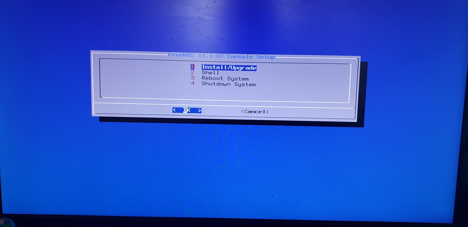

When I start the install I get to the blue screen with the gray box and the arrow keys dont work what can I do to get it to work?

Use the <Tab> key.

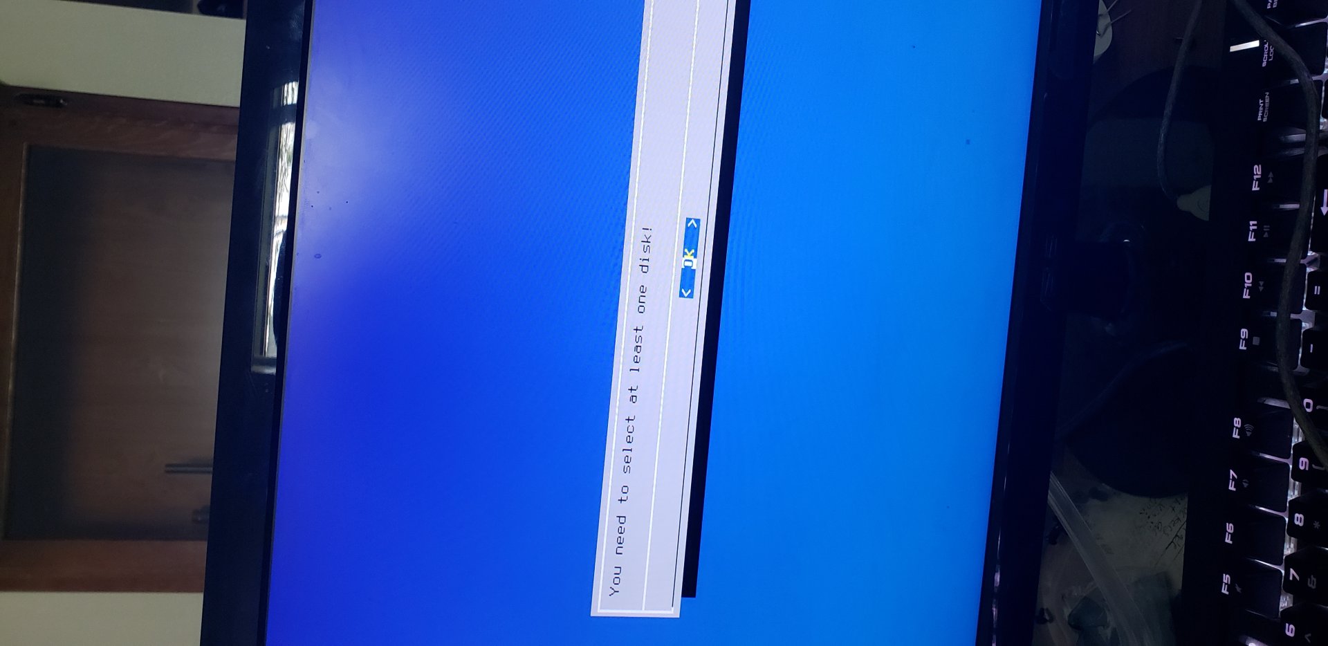

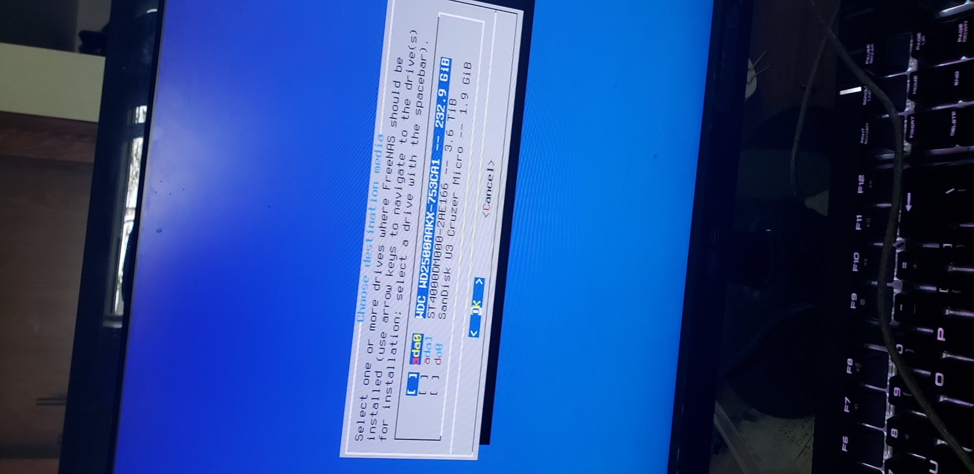

No that doesnt work I can get to the screen where I select the drive but I can't pick one its almost as if it mapped my keyboard wrong
Use the space bar to select a menu item.
Archerxplex
May 12, 2019
9
I've also relaunched it countless times and it keeps coming with the same issue I've tried doing it from USB and from a CD
Archerxplex
May 12, 2019
9
These are the keys that allow me to select ok (7,Q,Y,I,A, and space bar) also if I do (U+I and H+J) It also selects ok but (G+H) Moves it from ok to cancel

space bar should check the box for your disk when it's highlighted.
