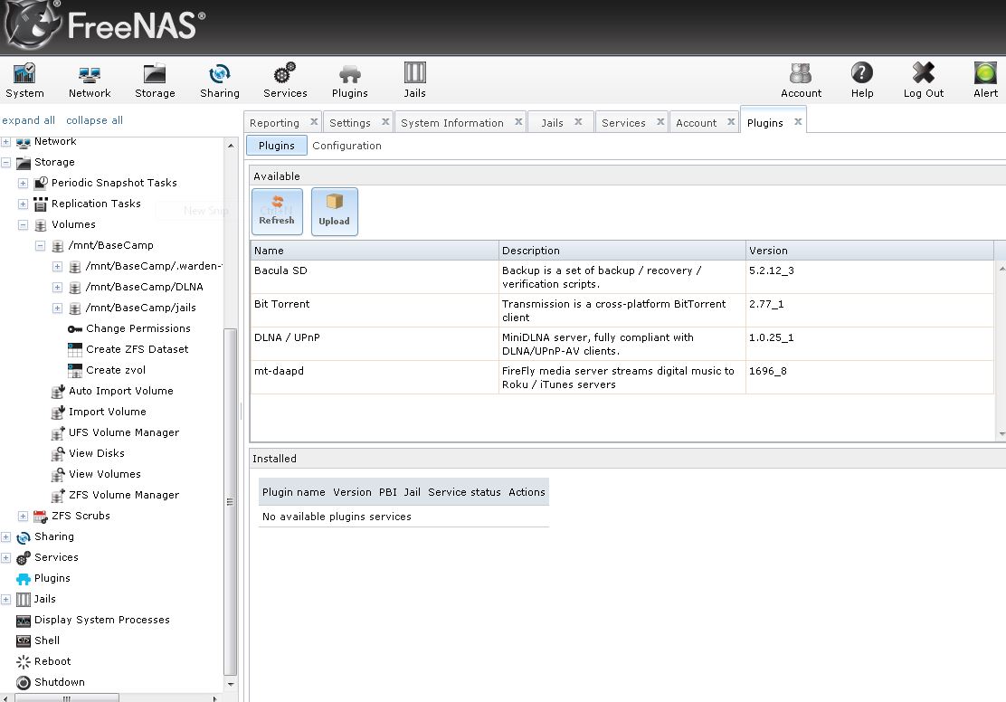

Different newb, same issue. Hopefully this isn't a hijack.
I can SSH into the box, SAMBA shares work, but I error out when trying to install included plugins.
Screenshot attached, here are logs: http://pastebin.com/VbKBAJ8g
Any help appreciated, thanks.
d12
Oct 4, 2013
4
Solved. Seems the issue was running FreeNAS-9.1.1-RELEASE-x86.iso i386: 32-bit x86 ISA. Worked fine with FreeNAS-9.1.1-RELEASE-x64.iso x86_64: 64-bit x86 ISA
