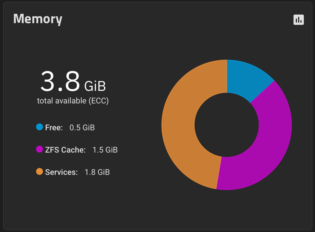

Hmmm, this could be why I couldn't get the current TrueNAS scale installer USB to boot on an ancient system of mine, but I was able to upgrade in place, after verifying that a mirrored current USB based install did work.
I thought it was perhaps requiring UEFI... altho the latest Dragonfish RC.1 certainly has no issue booting this system once its upgraded.
