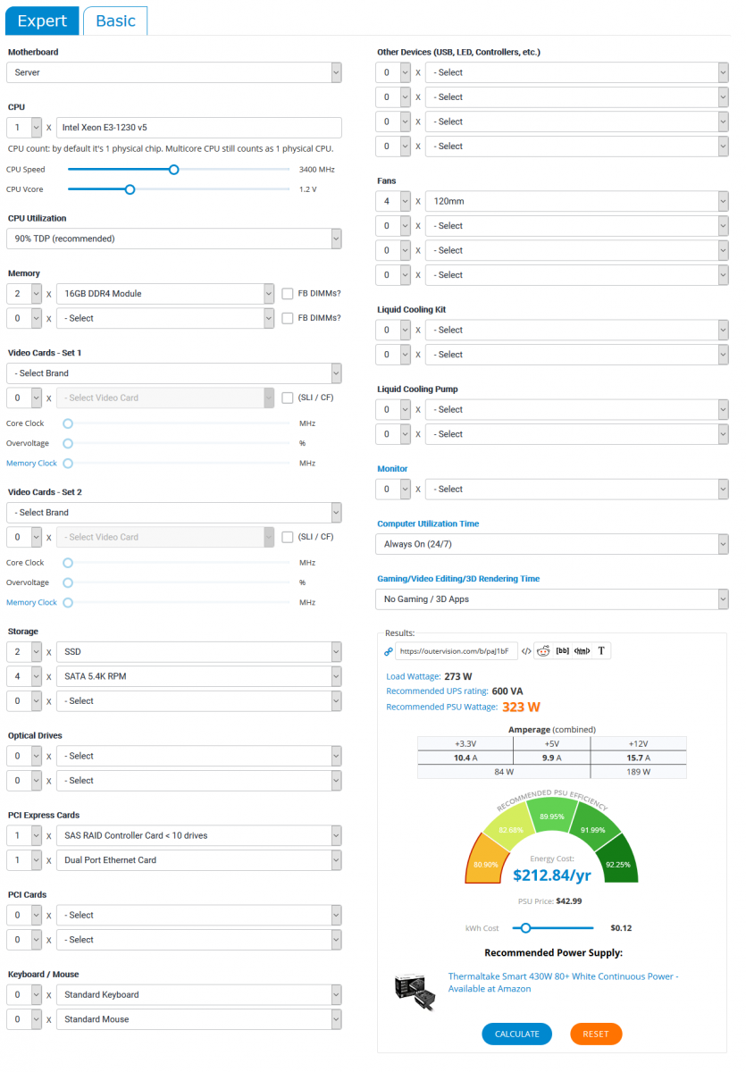

POWER: By doing some basic calculation (Please see the attachment file) I've decide that I can use Seasonic FOCUS GX-650W Gold (Focus GX-650) for example. What do you think?
In the attached file you have only put in 2 sticks of RAM -- your board supports 4
you also only put in 4 SATA drives and 2 SSDs -- your board supports 12 total drives.
My advice would be to max out the components that you can add to the board and case and then see the minimum power requirement. This means max memory, max number of drives, an HBA, CPU etc etc. This would allow you to expand in the future without having to buy another PSU in case the total power requirements go above the value rated on the PSU.
Secondly keep in mind that all the disks require spin up when you start the machine. The more the disks, the higher the power required. So keep around 25-30W per drive instead of the 10W that the online calculators usually use for each HDD.
Yeah, you are right about this power requirement estimations. But to be honest, I'm sure I will never go above 4 disks (as SATA) and 2 disks (as SSD)
I'm using this for home NAS and somebody have to pay the electricity bill ;>
What do you think about the power supply I proposed?
