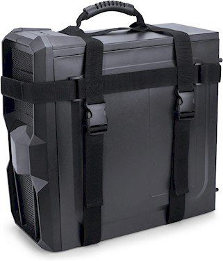

The killer point is the handle. With it, you're limited to LAN-party cases, which probably do without HDDs by now.
How good are your soldering skills? Or your sewing skills for a carrying harness?
Without the handle, a Jonsbo N1 looks like it would fit in a bag.

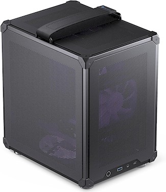

That's actually hitting close to what I'm looking for. :smile: Using the "straps" from a few posts above, it might in fact work perfectly.
Adding it to my shopping list.

Oh nice. I was familiar with the N5 but the N1 looks even more like a piece of small luggage.

The included backplane makes me nervous. I wonder if you can easily bypass it and just directly connect PSU power and SATA cables from the drives to the motherboard? (Especially if you only end up installing 2 HDDs.) It's hard to tell from the photos.
Er, you must mean N2 (N1 in cube shape) or N3 (8 disks). Or N4, since I just found there is now a micro-ATX case in the family (would be nice with a Gigabyte MC12-EC0) but I couldn't find a N5.
I suspect no because it is part of the drive locking mechanism. But what's the issue with the backplane? Even without hot-swap it means less clutter with power cables.
With the N1 the backplane does not even interfere with cooling, since air flows along the width of the drives rather than the length.
