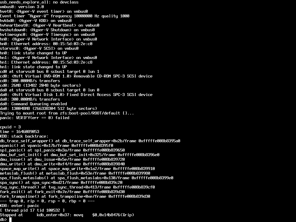

I am running TrueNAS vm under hyper-V cluster. It was woking fine for around 6 months but it fails today.
How do I force a fsck there?

You do not. ZFS does not have a fsck of any sort. It would be virtually impossible to fsck petabyte or exabyte sized filesystems. ZFS relies on its checksumming and self-healing capabilities to maintain the pool integrity.
You have potentially compromised this by virtualizing it in a non-recommended manner. This can cause fatal pool corruption if the hypervisor is writing stuff out to disks in an inconsistent pattern, perhaps cached, who knows. You should be following the guidance I posted many years ago at
One poster recently commented "but that's so old". Bad ideas do not get better with age. Good ideas age well. The information is still relevant.
You could potentially be in luck, however. It looks to me like it is your boot pool that is ruined. Your main data pool may be unaffected. Try reinstalling TrueNAS. If you can, then import the pool, and then realize that the bad thing that happened to your boot pool could also happen to your main pool. BACK UP YOUR MAIN POOL AS SOON AS POSSIBLE.

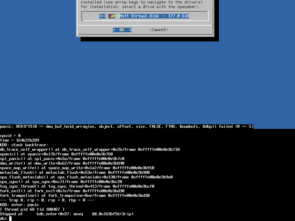

I am able to see it using: zpool import -f, but the server restarts when I try to recover it.
Mar 1 01:15:02 Cofre syslogd: last message repeated 4 times
Mar 1 01:15:21 Cofre login[82183]: ROOT LOGIN (root) ON ttyv0
Mar 1 01:24:10 Cofre syslogd: kernel boot file is /boot/kernel/kernel
Mar 1 01:24:10 Cofre kernel: [558] panic: VERIFY3(0 == dmu_buf_hold_array(os, object, offset, size, FALSE, FTAG, &numbufs, &dbp)) failed (0 == 5)
Mar 1 01:24:10 Cofre kernel: [558] cpuid = 3
Mar 1 01:24:10 Cofre kernel: [558] time = 1646108641
Mar 1 01:24:10 Cofre kernel: [558] KDB: stack backtrace:
Mar 1 01:24:10 Cofre kernel: [558] #0 0xffffffff8099fd15 at kdb_backtrace+0x65
Mar 1 01:24:10 Cofre kernel: [558] #1 0xffffffff80951d81 at vpanic+0x181
Mar 1 01:24:10 Cofre kernel: [558] #2 0xffffffff81aa904a at spl_panic+0x3a
Mar 1 01:24:10 Cofre kernel: [558] #3 0xffffffff81b0cac2 at dmu_write+0x62
Mar 1 01:24:10 Cofre kernel: [558] #4 0xffffffff81b98364 at space_map_write+0x194
Mar 1 01:24:10 Cofre kernel: [558] #5 0xffffffff81b65667 at metaslab_flush+0x3b7
Mar 1 01:24:10 Cofre kernel: [558] #6 0xffffffff81b8f759 at spa_flush_metaslabs+0x1a9
Mar 1 01:24:10 Cofre kernel: [558] #7 0xffffffff81b85fed at spa_sync+0xd6d
Mar 1 01:24:10 Cofre kernel: [558] #8 0xffffffff81b9a483 at txg_sync_thread+0x3b3
Mar 1 01:24:10 Cofre kernel: [558] #9 0xffffffff8090f5ce at fork_exit+0x7e
Mar 1 01:24:10 Cofre kernel: [558] #10 0xffffffff80cdd40e at fork_trampoline+0xe
Mar 1 01:24:10 Cofre kernel: [558] Uptime: 9m18s
Mar 1 01:24:10 Cofre kernel: ---<<BOOT>>---

I did this:
root@Cofre:~ # zpool import -o readonly=on -f -R /mnt/truenas/ boot-pool
root@Cofre:~ #
root@Cofre:~ # zpool status -xv
pool: boot-pool
state: ONLINE
corruption. Applications may be affected.
action: Restore the file in question if possible. Otherwise restore the
entire pool from backup.
see: https://openzfs.github.io/openzfs-docs/msg/ZFS-8000-8A
scan: scrub repaired 0B in 00:00:10 with 1 errors on Thu Feb 24 03:45:10 2022
config:
NAME STATE READ WRITE CKSUM
boot-pool ONLINE 0 0 0
da1p2 ONLINE 0 0 0
boot-pool/.system/rrd-17a88b624aa64e01b68939563b5fcb8c:/localhost/df-mnt-tank-data-volumes-mycompany-stable-rollbacks-stable-d587c/df_complex-free.rrd
root@Cofre:~
