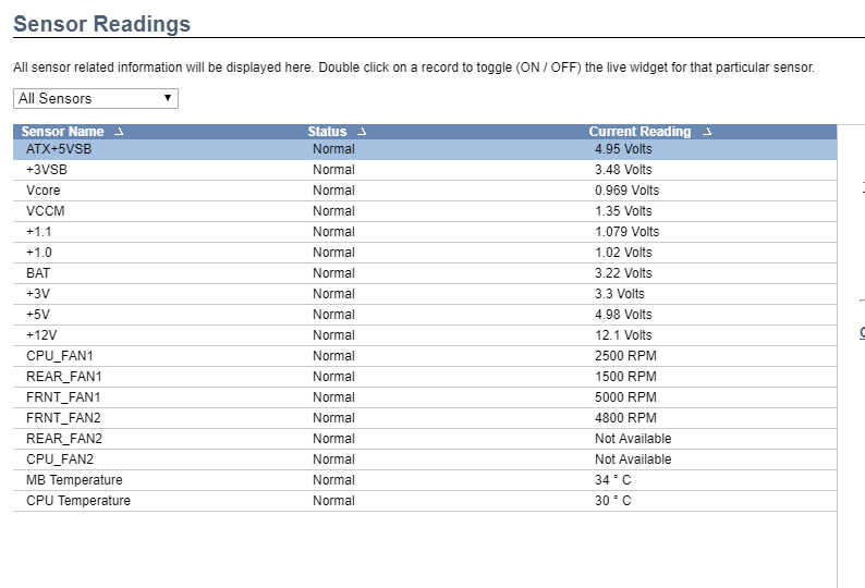

My running system has a green message "Host is currently on" immediately above the first radio button line "Reset Server".
Does yours show that even though, while power is obviously supplied to the mobo, the host is clearly "not on".
Yes, it says the host is on in green.
It is showing zero for +3V, +5V, +12V.
Is that normal?
All the others look normal.

Redcoat
Feb 18, 2014
2,925
Looks like your power supply's died:
DrKK
FreeNAS Generalissimo
Oct 15, 2013
3,630
Dead power supply, as I said, is the most common thing. And, as it happens, the cheapest to fix. :)
