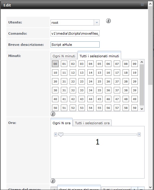

I tried but....it does not work :(
#!/bin/bash
SOURCE=/v1/media/aMule-disk/Incoming
DESTINATION=/v1/media/Film
FILES=`find "$SOURCE" -type f | grep '.mkv\|.mp4\.avi|\.srt'`
for f in $FILES
do
  while lsof -Fp $f  &>/dev/null
  do
   sleep 1
  done
  mv $f $DESTINATION
done
toadman
Jun 4, 2013
619
It's hard to debug "it doesn't work." What part doesn't work? It doesn't run? It doesn't find the files? It doesn't move the files? Etc...
If you have verified there are files of the given types in the source directory, what happens if you are logged in as root and run it from the command line? (Trying to isolate the issue to the script, or to the cron part.) You can temporarily replace the, "mv $f $DESTINATION" with "echo $f" if you want to see if it's finding the source files in the first place.
The script works on my machine when I tested it, so I know it's not completely broken. :)

Hi toadman, thanks for following up again. Actually the issue is that it does not move the files (yes, there are files with the given extension in the folder). I tried a couple of time to run the Cron Job and the files are not moving.
I will try again the next days or run the script from the command line and get back to you
