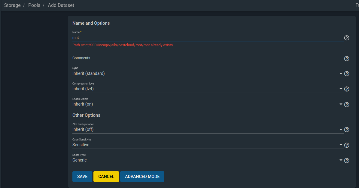

this part does exist /mnt/SSD/iocage/jails/nextcloud/root I posted a picture of my drive pool

baztardo.snow
May 8, 2020
38
Here a pic
baztardo.snow
May 8, 2020
38
It says /ROOT/mnt is there even tho the pool does nt show it .
