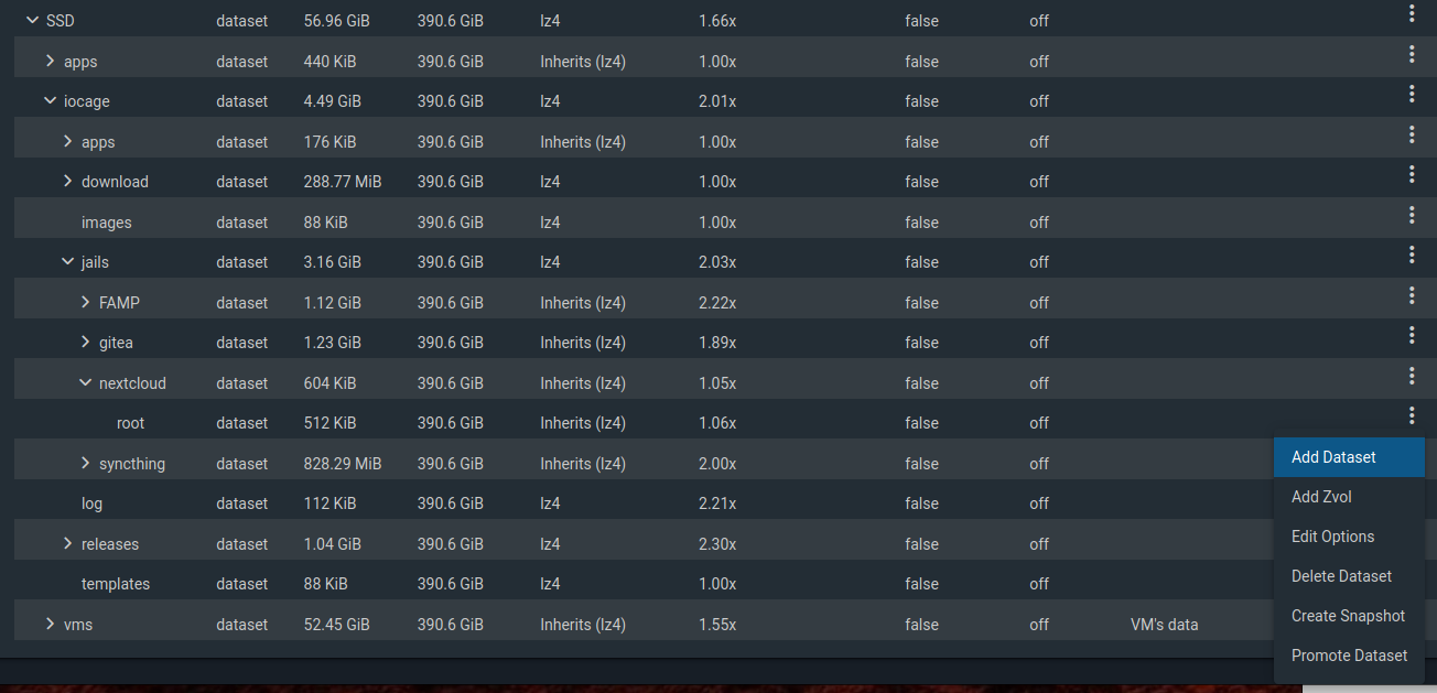

go to jail and then stop the jail and check the mount points from the Jails menu (not the storage menu you were showing pics for). Check How you are mapping your external dataset to the /mnt/SSD/iocage/jails/nextcloud/root/mnt/data

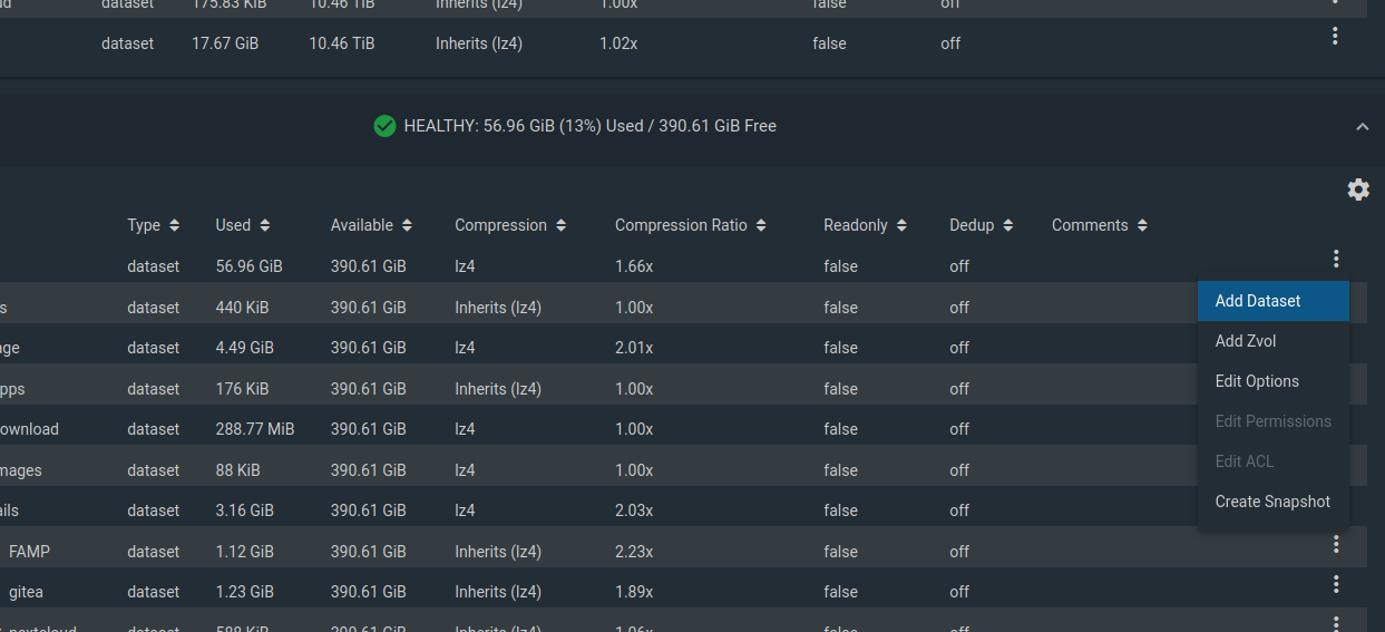

The permission are grey out at the parent there are not permissions for the childs

I stopped all the jails plugins and

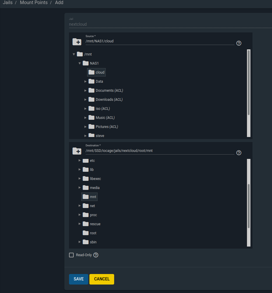

ok now this is more confusing the guide is to create those mount points from CLI when I got to the mount points under the there aren't any trying to add one ? I should I be adding them here instead of the CLI ?
I haven't written the instructions for the GUI for this part. If you want to use the GUI, tread your own path but I'm only really familiar with the CLI so that's all I can really provide help for aside from making commonsense observations :)
