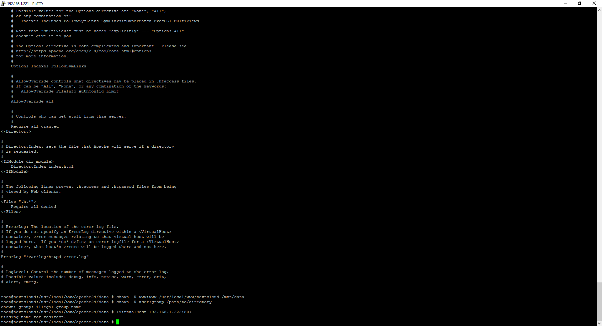

Please helppppp !!!
So I got to the permission part where I have to use the command:
chown -R user:group /path/to/directory
but it give me an error saying that illegal group name. Anybody have any idea ?
samuel-emrys
Dec 14, 2018
136
Please helppppp !!!
but it give me an error saying that illegal group name. Anybody have any idea ? View attachment 27425
This isn't a command you need to enter. I provided this as a description of what's going on in the previous command you executed. Explicitly:
chown -R www:www /usr/local/www/nextcloud /mnt/data
changes the ownership of the directories /usr/local/www/nextcloud and /mnt/data to the user "www", and the group "www", defined by the format you tried to enter:
No need to enter the format, this is just for your information.

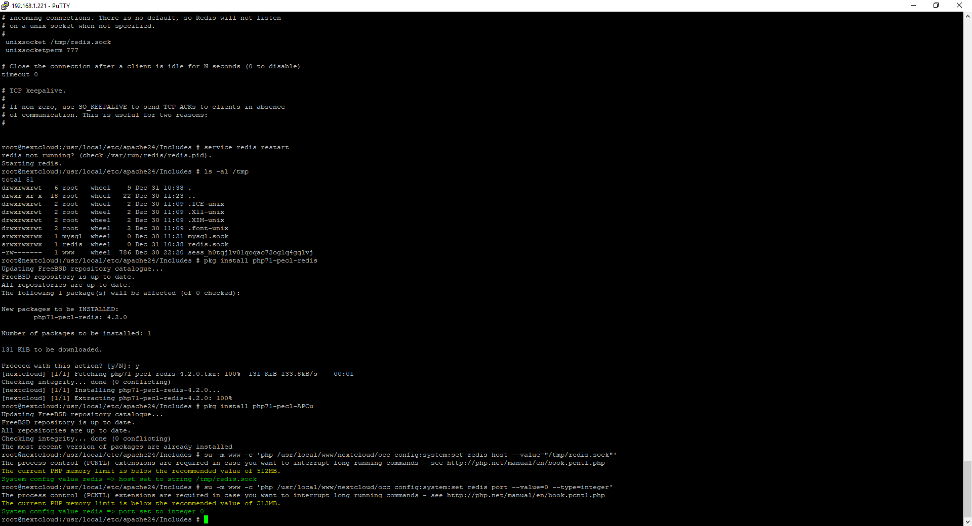

in the caching and redis section. When I enter this command:
$ su -m www -c 'php /usr/local/www/nextcloud/occ config:system:set redis host --value="/tmp/redis.sock"'
$ su -m www -c 'php /usr/local/www/nextcloud/occ config:system:set redis port --value=0 --type=integer'
it give me the message below in the picture. Can any body tell me if that's something that suppose to happen or am I doing something wrong here ?
dureal99d
Aug 3, 2017
156

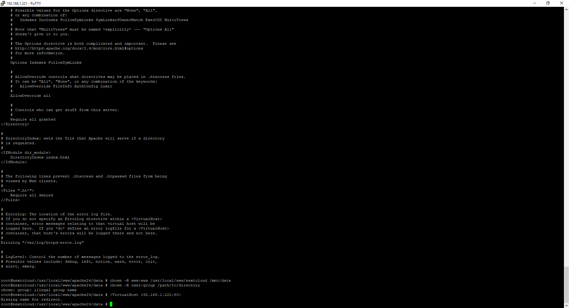

So onto the next part when configuring the email. When I typed in this command:
nano /var/log/maillog
and this is the log a get which pretty means error everywhere....
samuel-emrys
Dec 14, 2018
136
and this is the log a get which pretty means error everywhere.... View attachment 27436
Bearing in mind that I have zero experience configuring postfix for yahoo, my guess would be that you haven't configured the yahoo smtp server correctly. My advice would be to set up a new gmail account specifically for server notifications and follow the guide exactly, as I can confirm this works. However, if you're intent on using yahoo you'll have to do your own research to work out what configuration you need.
Looking at the log you posted, it seems to be throwing errors because you've put the wrong smtp server domain in. This Yahoo SMTP guide provides a walkthrough for SMTP for yahoo. Noteably, you have used:
smtp.yahoo.com:587
This needs to be
smtp.mail.yahoo.com:587
Another hurdle you might have with yahoo is configuration of the mailbox is to allow "Less Secure Apps" to use the mailbox; this is relatively well documented for gmail, but you'd have to research if this is something that can be configured (or if it even needs to be configured) for yahoo.
Edit: Derp, a discussion of "Less Secure Apps" is covered in the guide I linked, just had to read down a little bit
