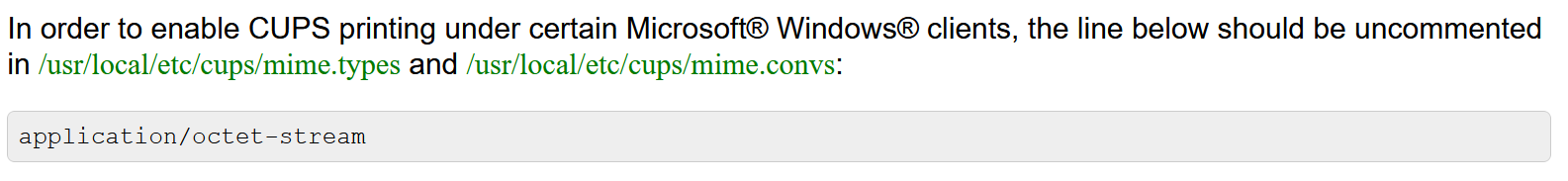

What about that:
I am mainly printing from my Windows PC. Should I care and edit those two files.
(I know at this step it's not TrueNAS related but you seem pretty well versed in FreeBESD stuff)
Thanks again!
9,703
I'm not really sure, but I'm guessing the reference to "certain Windows Clients" means legacy ones, so if you're on Windows 10, forget it. As long as you can print what you want, it's all good.
I am not sure what I am supposed to edit here since in the FreeBSD doc there were no mention of that.
The file itself points to the manual (man cupsd.conf)
If it's already doing what you wanted, you can leave it like that (although I'm assuming you're behind a properly managed firewall, otherwise, consider looking into secure configuration).
