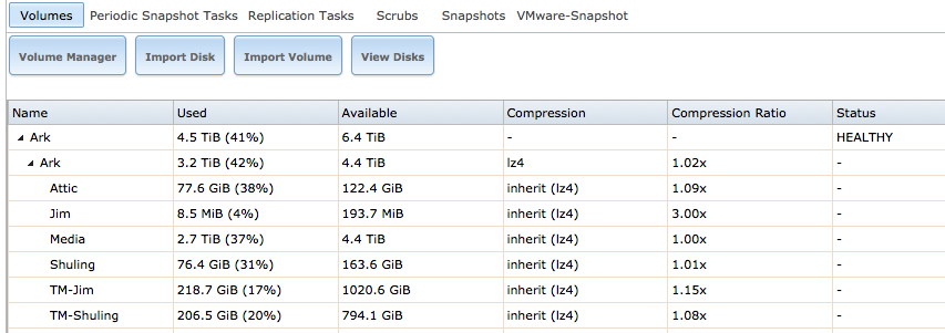

I'm not sure I fully understand exactly what is going on. In the web gui, if you click on the Storage icon, you should see something like this:

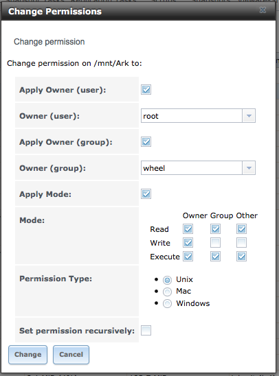

The first line is the volume, in my case Ark. The second line is a root dataset of the same name, created automatically. My experience is that you should not change any settings or share the root dataset. Instead, create datasets inside it and share them. So Attic, etc. are datasets that I created and are shared. The dataset Jim is my home directory; it was created automatically when I set up my user.
So in your case, you mention the dataset 'mainVolume'. That sounds like the root dataset and you should not be messing with it. By default its user/group are root/wheel and that's the way I would leave it. Here is the permissions dialog for a root dataset:
My suggestion is to revert your root dataset to this state, remove any shares, get your home directory set up, and create a share for it and anything else you want.
