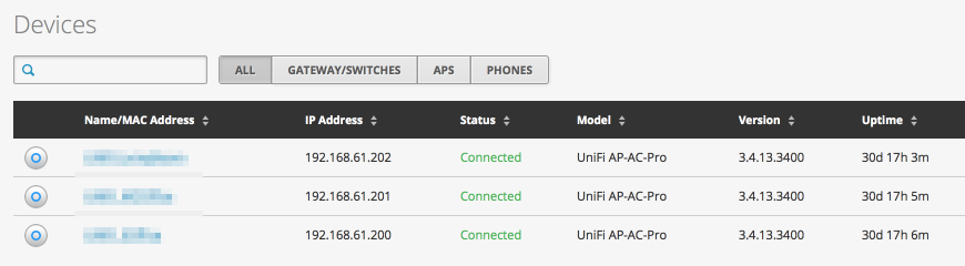

I recall the issue with adopting the unifi access points is that the dev's have started compressing the traffic/packages between controller and APs now. If you check your logs you'll see the failure point. You can fix it by upgrading snappy-java, i.e
cd /usr/ports/archivers/snappy-java/
make install clean
Its a google thang, for more info see https://github.com/xerial/snappy-java
then you should be good. If I get a bit more time I'll try and provide some step by step instructions. Hope this helps. The version I'm running has been rock solid, including with multicasts for AppleTV/Android Shield/Airtime. The newer version is less so so Ive help back from it for now in production.
