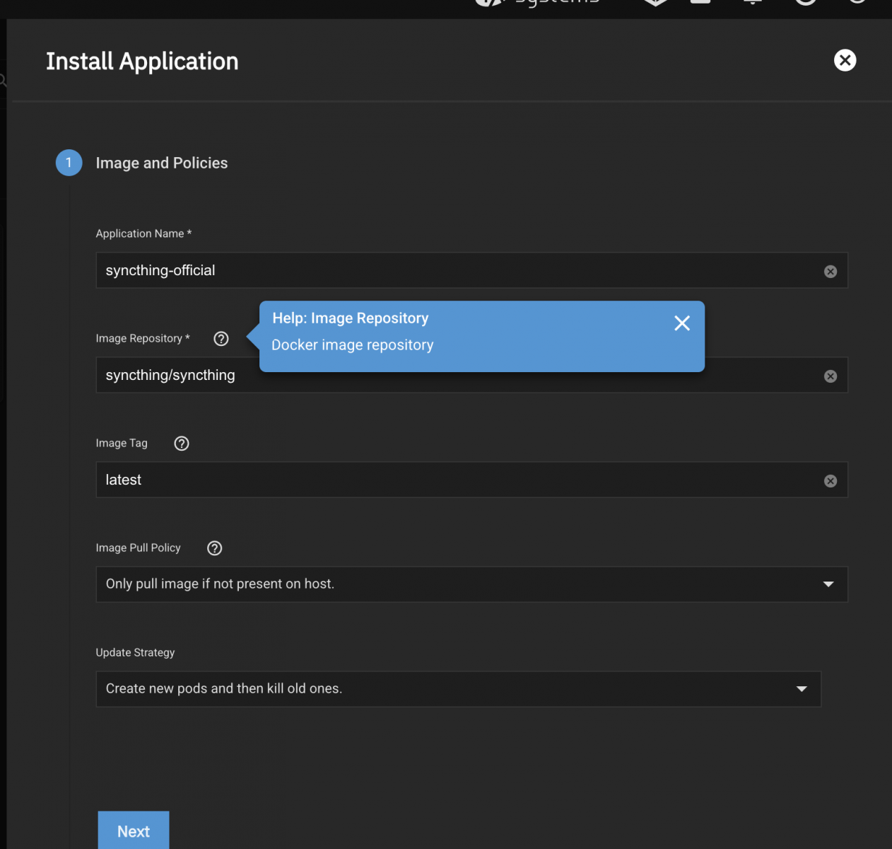

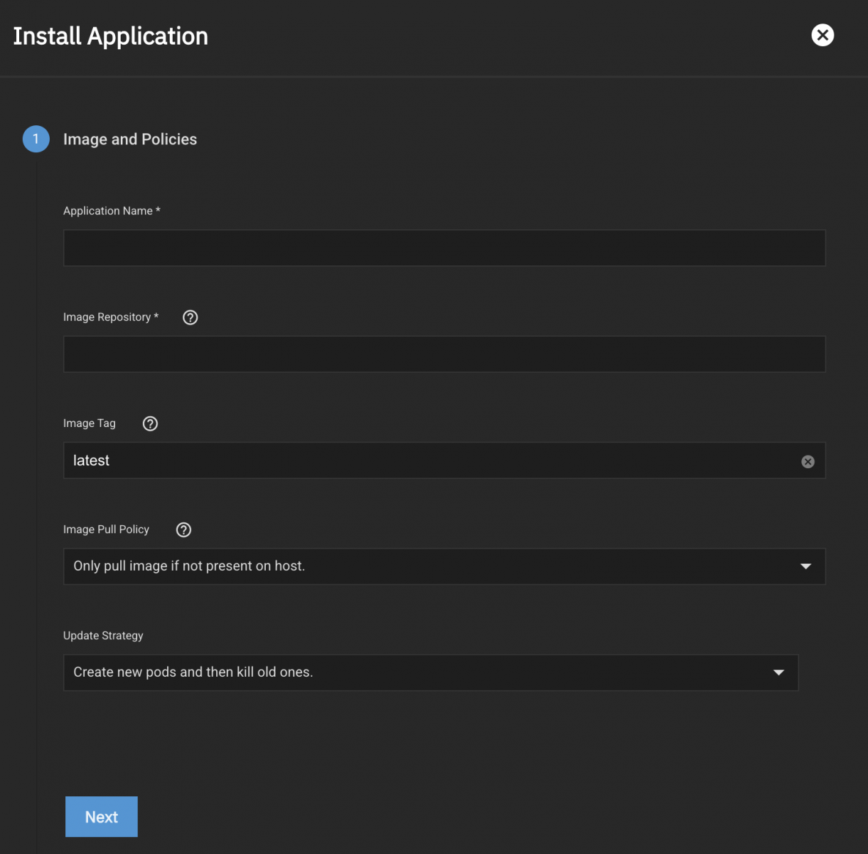

OK, I reinstalled a new TrueNAS Scale using the latest nightly, and I'm trying to get Syncthing running there.
From the TrueNAS UI, I click on "Apps" on the left hand menu, then click on "Launch Docker Image" in the top right.
For Application Name - I believe this is just an arbitrary name to identify this docker container on the TrueNAS host right?
For Image Repository, I pick "syncthing/syncthing". The other options I leave at defaults:
For Container Settings, I don't set any of these, and leave at defaults.
For Networking, I don't set any of these, and leave at defaults - this means it should default to Docker's default of bridge networking, and the container should get an IP address like any other host on the local network, right?
For Port Forwarding, I don't set any of these - I believe the Syncthing docker file already exposes certain ports - so we should be fine here, right?

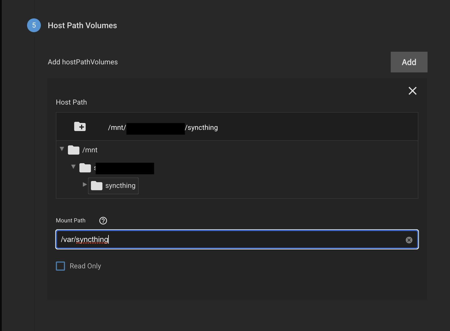

For Host Path Volumes - my understanding is that is just Bind mounts from docker - so I created a new Dataset on my ZFS pool, and linked that to "/var/syncthing" in the container:
For Volumes - this is named/unnamed volumes, I didn't set up any of these.
For Security Settings, I did tick the "Privileged" box.
After that, I create and run the container.
