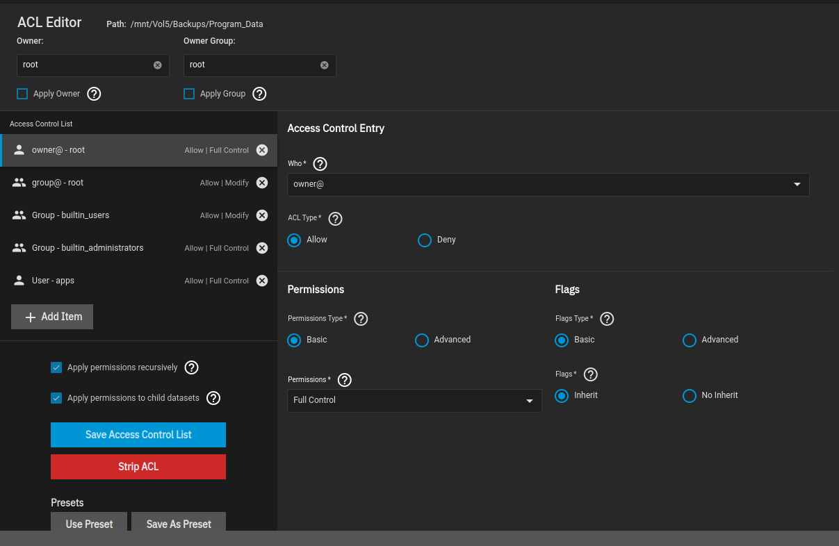

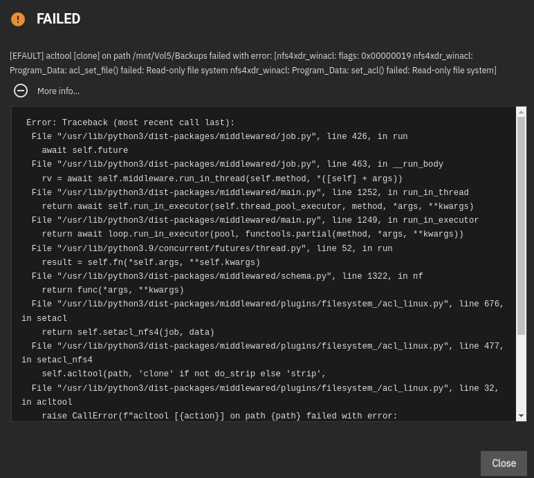

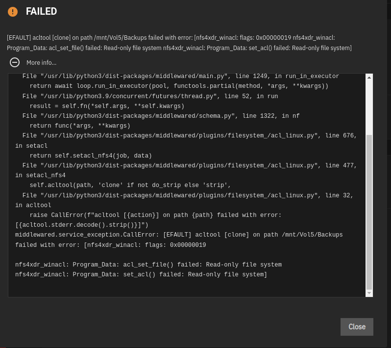

I then go into Backups/Program_Data and check the Dataset, all permissions are fine from what i can see but the Syncthing app doesn't let me work with the Backups dataset and also replication task now fails saying permission denied in writing to it. Here are a few screen shots of errors.

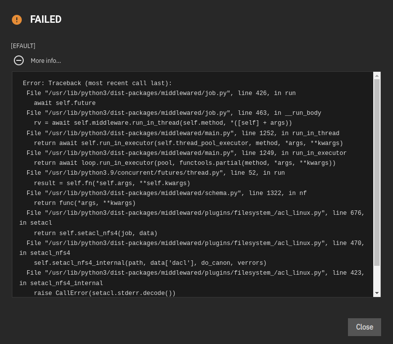

Scrap that last message it's still got the issue, it worked for a moment and then the issue has come back, i'm also having issues updating the permissions where it shows an error and fails but seems to set the permissions fine.

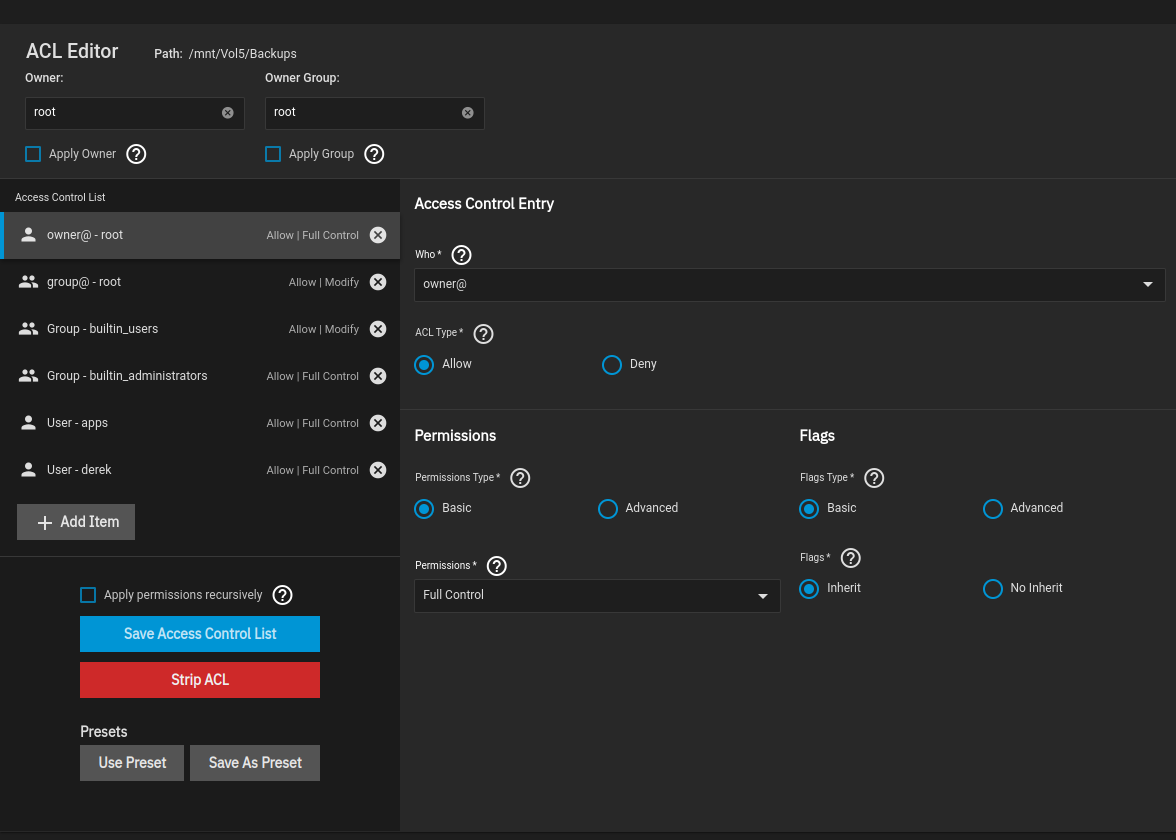

Created a Dataset called Backups and inside this we have Program_Data and Emby. At first i give Backups all the right permissions for root, apps and the user Derek and applied it all recursively with child datasets ticked, this still didn't work. I then gave both Emby and Program Data the right permissions for root, apps and user Derek and applied it all recursively with child datasets ticked. This then worked for Syncthing.

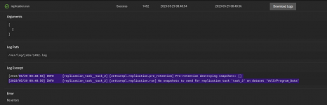

I then synced Backups dataset on the server with a folder called Backups on a secondary hard drive on the desktop and it seemed to start syncing with the weird thing, Backups Dataset both Emby & Program_Data show fine and also all of the datasets created for each app so Syncthing, NetData, Jellyfin, Mymediaforalexa and so on but with the issue all of the folders that syncthing syncs to the desktop are empty.

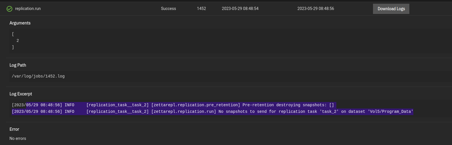

I went into replication tasks and i have a replication that copies Program_Data to Backups/Program_Data and it says success every time i run it but with the second photo it doesn't seem to do anything in terms of copying over any data other than the apps Datasets without any data inside IE the apps settings.

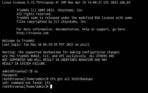

I'm running it in the Truenas shell on a fresh install of Truenas, have just added my pools, changed a few permissions on some datasets installed a few apps and added a few smb shares. I even used su to log in as root and run command?

Well, something is very broken with your system... at very least, the path doesn't have core ZFS utilities in it.
what does this get you:

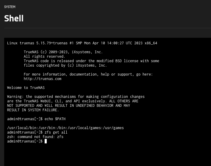

echo $PATH

That command gets me
/usr/local/bin:/usr/bin:/bin:/usr/local/games:/usr/games

Looks like it has been edited by someone/something... it should look like this: /root/bin:/usr/local/sbin:/usr/local/bin:/usr/sbin:/usr/bin:/sbin:/bin
You're missing all the sbin references and some others too.

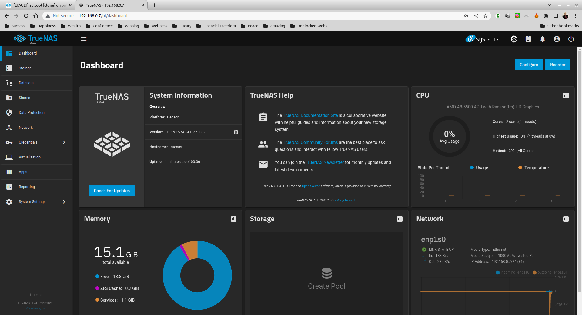

I downloaded a fresh Truenas Iso and have created a boot drive on a SD card due to the fact i'm waiting for some new memory sticks. After installing i have made 0 changes, just a fresh install. No users added, no pools added, no apps nothing but a fresh install. I log into the Truenas gui, jump into shell and type echo $PATH with the same outcome as before.

I have created a boot drive and installed Truenas on a spare SSD on my old server hardware which i was using before i made the switch and it ran completely fine and as soon as i run the command echo $PATH the exact same outcome happens.
Running zfs get all and again i am greeted with
zsh: command not found: zfs
That's a little weird that 2 different ssd's with different Truenas installs running on different hardware both show the same errors?

If you keep restoring your config, the broken path will continue to return.
Also, SSD is the preferred boot pool media, not USB stick or SD card (which are likely to burn out relatively quickly.

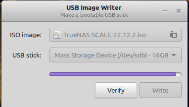

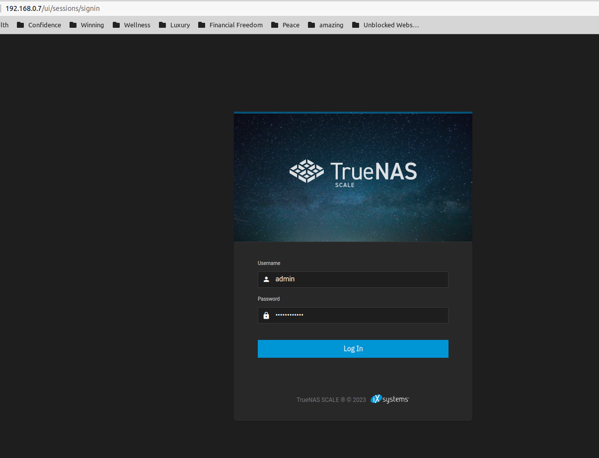

Literally as in the pics below
1 - create an install drive with the SD card (only thing i got to hand till the usb memory sticks come in the post)
2 - Boot both the desktop and server individually and use the install drive to install a stock Truenas install on a Sandisk 128GB Sata SSD
3 - Once installed restart and wait for it to boot and then on my laptop drop into the Cli
4 - Open the Shell and run the commands as shown
5 - Both desktop & server and Truenas 22.12.1 & 22.12.2 both have the same outcomes?
Thank you everyone for this help even if it's frustrating me it's appreciated :)
