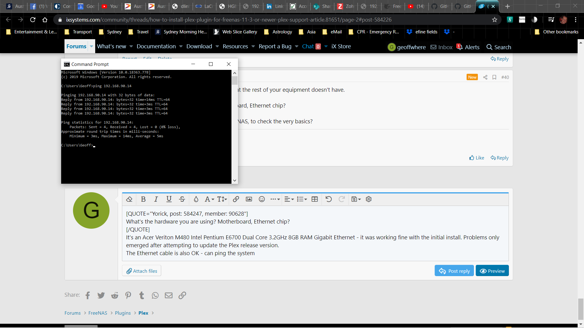

What's the hardware you are using? Motherboard, Ethernet chip?
It's an Acer Veriton M480 Intel Pentium E6700 Dual Core 3.2GHz 8GB RAM Gigabit Ethernet, new 4TB WD Red data HDD and 320GB system boot drive. It was working fine with the initial install. Problems only emerged after attempting to update the Plex release version.
The Ethernet cable is also OK - can ping the system and the dashboard indicates all's well:

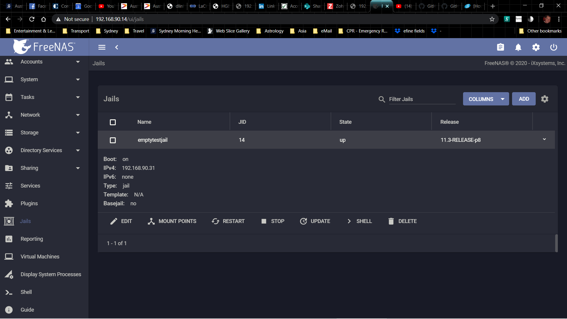

This jail you created: That's using DHCP? And it gets an address?

So, I've deleted the old 'emptytestjail' and created a new one - plex, IP address 192.168.90.30, it seemed to take a while for DHCP to assign the IP address, but it eventually got there. I've downloaded PuTTY and tried to login to FreeNAS root (192.168.90.14/24) but 'Access denied' when entering the root password. Also tried Putty access to the plex jail IP address, no go.
I understand the next step is to download the Danb35 script but it looks like I need help getting to that point, as per the above roadblocks.

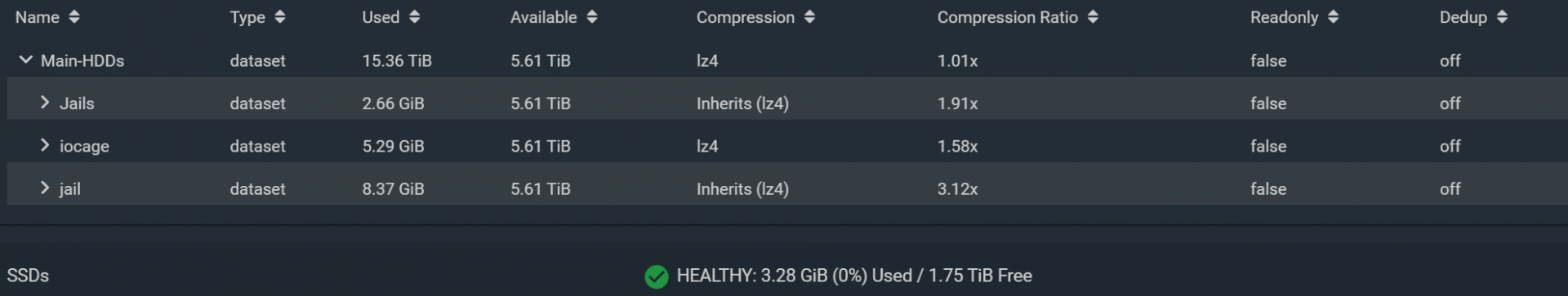

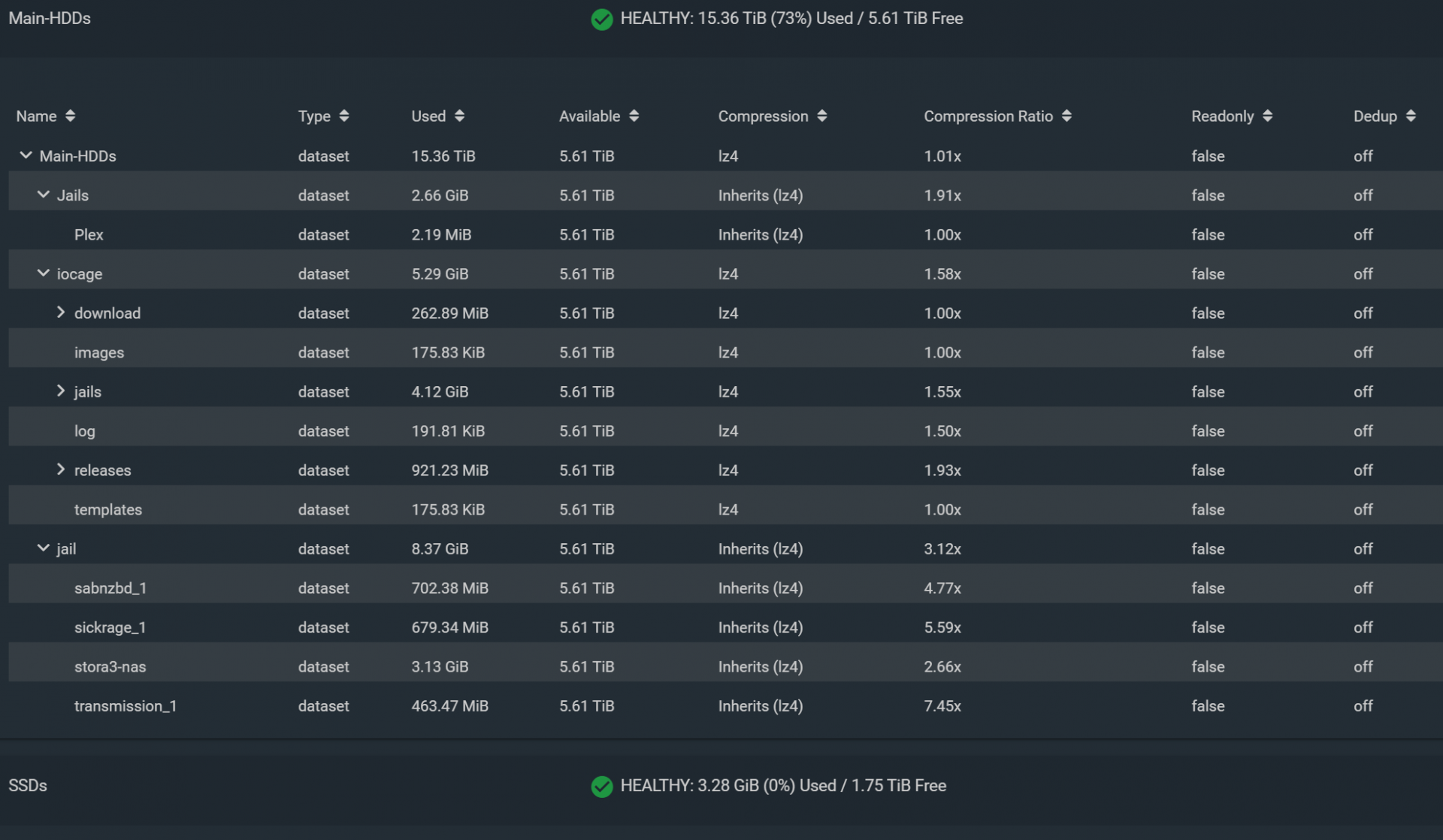

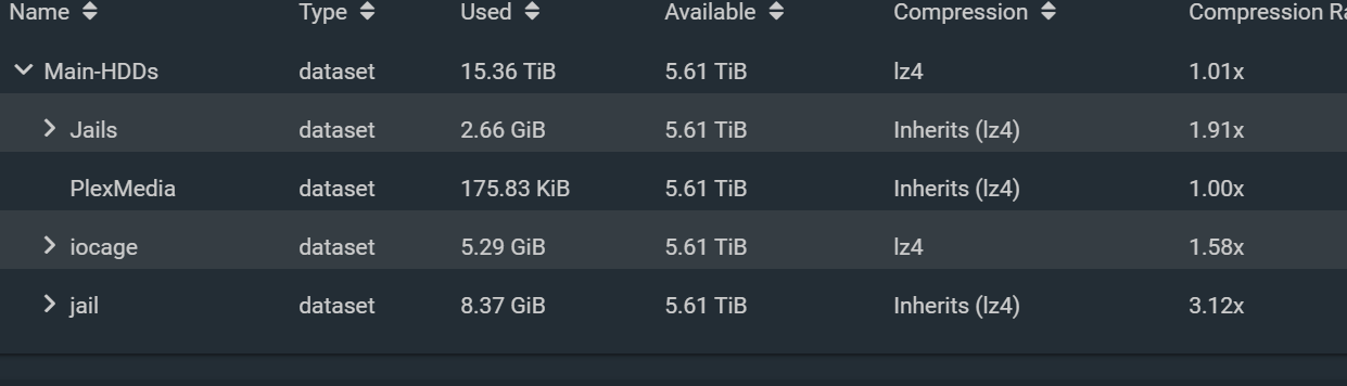

Main-HDDs dataset 15.36TiB
Jails dataset 2.66GiB​
Plex dataset 2.19MiB​
iocage dataset 5.29Gib​
stuff...​
jail​
stuff...​

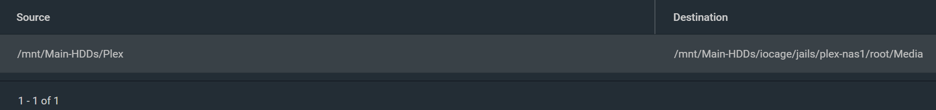

So the Plex that's under Main-HDDs/Jails is the dataset that interests me. There is one Mount Point for the PLEX jail:
Source: /mnt/Main-HDDs/Plex, Destination: /mnt/Main-HDDs/iocage/jails/plex-nas1/root/Media
The only thing under the Plex umbrella, is folders that exclusively contain subfolders with PLEX media files

So here's where I am unclear: You say /mnt/Main-HDDs/Plex, but above all I see is /mnt/Main-HDDs/Jails/Plex, and that seems too small to hold all your movies.
Now it's possible Main-HDDs/Jails/Plex was meant to hold your metadata, in which case leave it be. But if it was created as an SMB type dataset, and the intent was that movies and such would live there, and Main-HDDs/Plex is just a folder, then you want to move all your media files into Main-HDDs/Jails/Plex, mount that into Plex, and set permissions there.

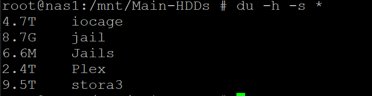

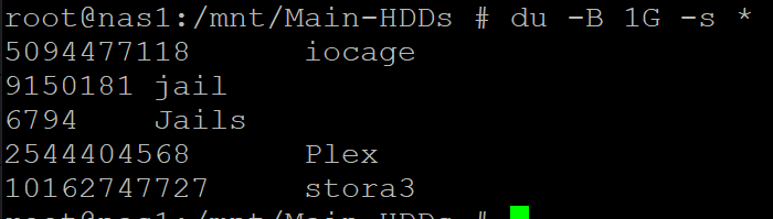

Actually, I have always wondered about that. It's not reporting correctly, as you can see here:

Main-HDDs/Plex is a folder. Rather than repeat myself, everything above holds - move your Plex media into a dataset, that Jails/Plex one seems as good a target as any, that was likely meant to be the dataset for media in the first place. Or create a new (SMB) dataset called Media or Plex-Media and move it there. The point is to have an easy starting point to edit permissions from without needing to drop into CLI for that.
delovelady
Nov 3, 2019
16
Thanks, I get it now. I've created the dataset, and have applied the ACL. This is what I originally wanted to do but I confused myself.
The next challenge, is getting the data into the right place. The data at /mnt/Main-HDDs/Plex has historically been seen by the jail as /Media/ compliments of this mount point:
The new dataset name is PlexMedia.
I have now changed the above mount to instead be sourced at /mnt/Main-HDDs/PlexMedia.
