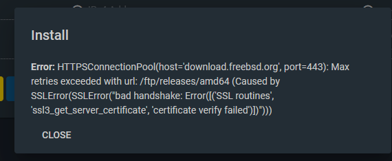

I'm running out of patience trying to understand why the Plex plugin can't be downloaded by my Freenas 11.3. It was previously installed on a 11.2 U8 without any problems but I screwed up my configuration, trying to make some clean on my dataset and permissions related to (overwritting permissions from root dataset of my pool).
Plex wasn't working at all after that. I finally decided to erase iocage dataset, upgrade to 11.3 and rebuild my configuration from scratch. I was able to import my pool, reinstall Qbittorrent plugins but still unable to install Plex ... I have the error below.
Please suggest me as I'm working on it for several hours now and I don't even see any resolution leads ...
Error: plexmediaserver had a failure Exception: RuntimeError Message: pkg error: - Certificate verification failed for /C=US/O=DigiCert Inc/OU=www.digicert.com/CN=DigiCert Global Root CA 12933140:error:14090086:SSL routines:ssl3_get_server_certificate:certificate verify failed:/freenas-releng/freenas/_BE/os/crypto/openssl/ssl/s3_clnt.c:1269: Certificate verification failed for /C=US/O=DigiCert Inc/OU=www.digicert.com/CN=DigiCert Global Root CA 12933140:error:14090086:SSL routines:ssl3_get_server_certificate:certificate verify failed:/freenas-releng/freenas/_BE/os/crypto/openssl/ssl/s3_clnt.c:1269: Certificate verification failed for /C=US/O=DigiCert Inc/OU=www.digicert.com/CN=DigiCert Global Root CA 12933140:error:14090086:SSL routines:ssl3_get_server_certificate:certificate verify failed:/freenas-releng/freenas/_BE/os/crypto/openssl/ssl/s3_clnt.c:1269: pkg-static: http://pkg.cdn.trueos.org/iocage/11.3-RELEASE/meta.txz: Authentication error Certificate verification failed for /C=US/O=DigiCert Inc/OU=www.digicert.com/CN=DigiCert Global Root CA 12933140:error:14090086:SSL routines:ssl3_get_server_certificate:certificate verify failed:/freenas-releng/freenas/_BE/os/crypto/openssl/ssl/s3_clnt.c:1269: Certificate verification failed for /C=US/O=DigiCert Inc/OU=www.digicert.com/CN=DigiCert Global Root CA 12933140:error:14090086:SSL routines:ssl3_get_server_certificate:certificate verify failed:/freenas-releng/freenas/_BE/os/crypto/openssl/ssl/s3_clnt.c:1269: Certificate verification failed for /C=US/O=DigiCert Inc/OU=www.digicert.com/CN=DigiCert Global Root CA 12933140:error:14090086:SSL routines:ssl3_get_server_certificate:certificate verify failed:/freenas-releng/freenas/_BE/os/crypto/openssl/ssl/s3_clnt.c:1269: pkg-static: http://pkg.cdn.trueos.org/iocage/11.3-RELEASE/packagesite.txz: Authentication error Please check your network Partial plugin destroyed

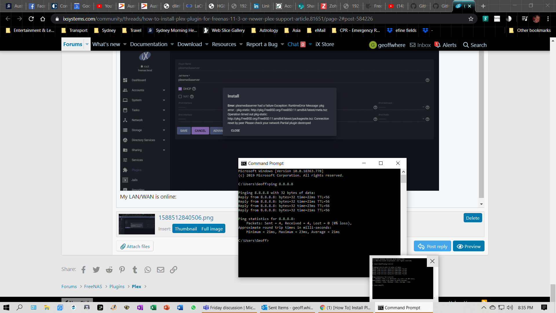

I'm likewise having similar problems. I'd successfully installed Plex on FreeNAS and both were running smoothly. Then, being a bit of a stickler for keeping up to date, when Plex told me there's a new version I tried to update - the beginning of my troubles. So many different ways to go about it on these forums, but I chose one path which didn't work. Then another, deeper doo doo.
After much disappointment and frustration, I followed other advice which said to remove the Plugin and delete the Jail to begin over. So I deleted both. Then researched for a viable method to reinstall and chose the Plex Server support forum, after previous attempts told me that Plex could not gather a DHCP address (my LAN is configured to issue DHCP), so I attempted (several times) to install with a static IP address.
Plex Plugin install progressed to 50% (-ffmpeg) then failed with this error message:
Testing Host DNS response . . . Error DNS Exception Timed Out pkg.FreeBSD.org could not be reached (my LAN/WAN is online and I can ping 8.8.8.8).
Help, please!
Further attempt just now to install Plex Plugin with DHCP option checked produced this result:
Error: plexmediaserver had a failure Exception: RuntimeError Message: + Acquiring DHCP address: FAILED, address received: 0.0.0.0/8 Stopped plexmediaserver due to DHCP failure Partial plugin destroyed

I just now tried again to install the Plex plugin from the FreeNAS plugin page - after 3 retries this was the result:
My LAN/WAN is online:
