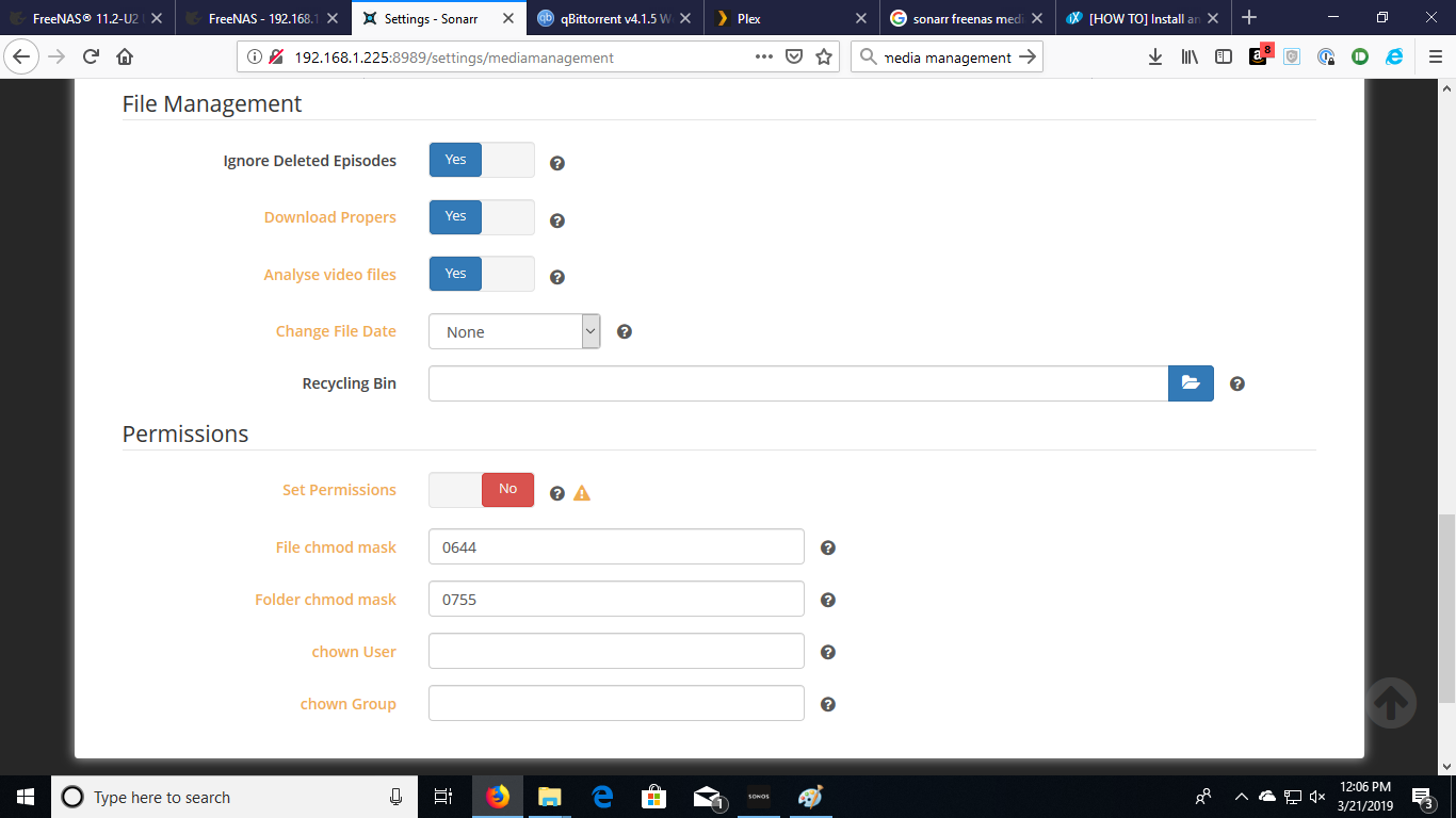

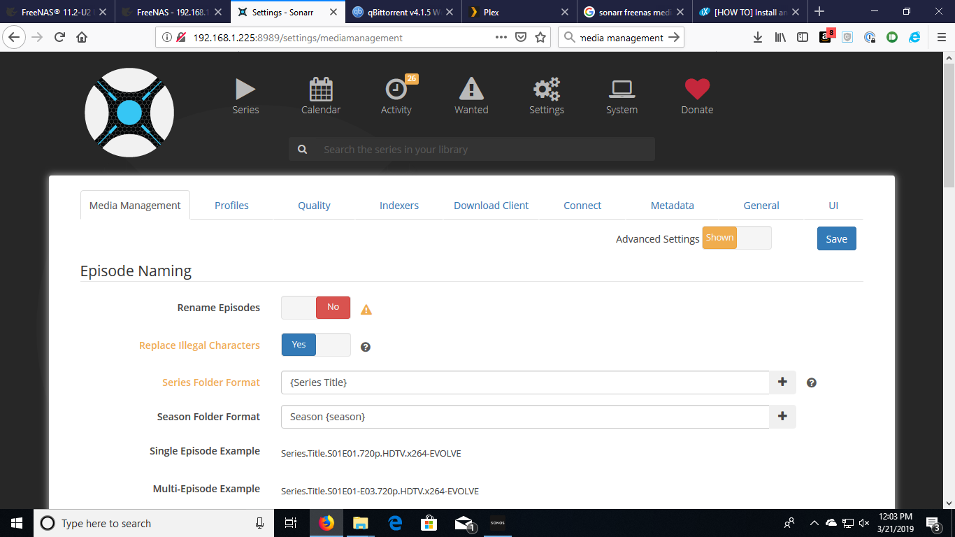

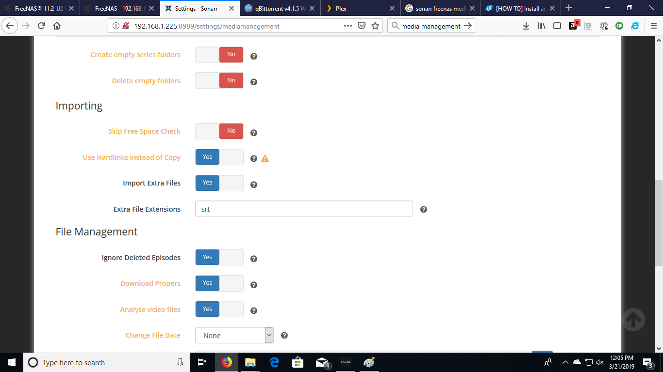

Thank you for this guide.. it was extremely helpful in setting up and resolving issues I was having with Sonarr. After finally getting it up and running, it recognizes the folders in which my shows are located and prompts qBittorrent to download new episodes. The issue I am now having it qBittorrent downloads everything to its native folder '/root/downloads/tv-sonarr'; while sonarr shows the episodes as downloaded, they will not show up in plex nor are they imported and relocated by sonarr. Wondering if I need to setup mount points or add permissions so sonarr can move downloaded files to their respective folders. Attaching some screenshots of the media management window.. thank you!
