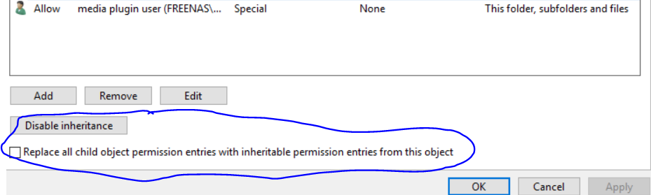

It all seems to be working correctly however i am having problems with permissions and would appreciate any help available
I have my windows share which i have added newmedia to as instructed, however when a new file is created by newmedia only newmedia has permissions for it, and i am unable to modify or delete that file when logged into my windows share.
Obviously if i log into the share using newuser then i have modify rights but i would have thought hat new files would inherit permissions from parent folders
Im totally open to the idea that im a total noob but any help or enlightenment would be great
Make sure that you don't have inherit permissions disabled when you are configuring them in windows.
Hope this helps.

I followed your guide. Very helpful, though I seem to have a permissions issue. When the files download via Sabnzbd, I am not able to open them or copy them. I get the following error message in Windows:
"You need permission to perform this action. You require permission from FREENAS\newmedia to make changes to this file"
I am able to open any other files on my FreeNAS share, just not any that have been downloaded via the jailed Sabnzbd install. When I check permissions in Windows, I see that newmedia has Full Control permission to the root of the share, but doesn't seem to have permissions to any child folders. I do get the following error in Windows when trying to set the permissions:
"Remotely setting permissions on the folder at the root of a share removes all inherited permissions from the root folder and all subfolders. To set permissions without removing the inherited permissions, click No and either change the permissions on a child folder or make the changes while logged in locally."
If I try to set permissions on a child folder, I get the following error:
"An error occurred while applying security information to Z:\movies Failed to enumerate objects in the container. Access is denied."
Any advice on what the issue is and what I need to do to resolve? Thank you!
Jul 10, 2018
25
What it sounds like to me is that you have inherit set with the newmedia user in windows and not for the others. I would recommend against giving newmedia full control, because that means newmedia has the ability to modify permissions. When you add newmedia you want to have everything checked except full control.
What I would do at this point is remove the newmedia user in windows and start again. You shouldn't need to check the box "Replace all child object permission entries with inheritable permission entries from this object".
A real quick and easy fix to this would be to allow guest access for the share in freenas. The drawback is that anyone on your network would have access to the share then.
One more thing I can recommend is create a user in freenas with the same username and password as your windows user. Add wheel to it's auxiliary group. This should ensure that your windows user has full control as root and wheel are the default owners of a windows share.
I hope this is helpful. I know it's a pain, but when in doubt start over and try again.
