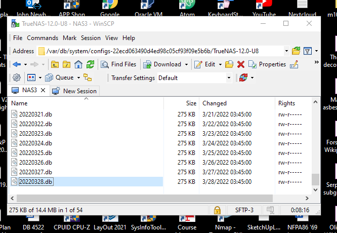

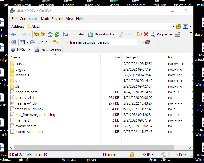

Do you have WinSCP on your Windows machine and SSH access to your TrueNAS box? If so, use WinSCP to open the most recent /var/db/system/configs-"big number" folder, open the latest TrueNAS version file and find the most recent "pre format event" .db file - see screenshot here.
Copy that file to /data as freenas-v1.db
Reboot and you should find your earlier configuration is back.
Good luck!
