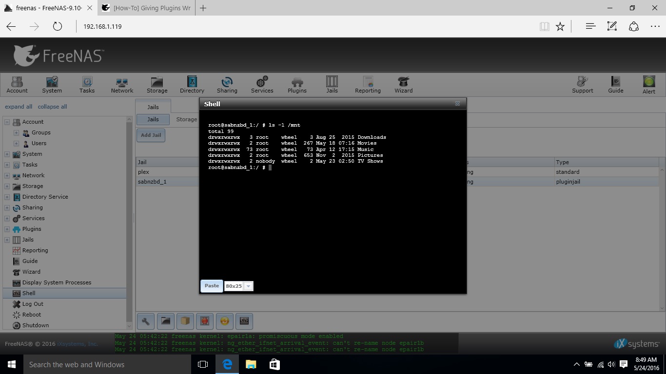

I have tried a few things in this excellent thread to try and get Sabnzbd to work. After install last night, it ran and I was able to configure it to work and downloaded some content just to see. This morning, the service was off and would not restart in the FreeNAS webGUI yet I could access it using my laptop using MS Edge and it is still running. I did download the latest update for FreeNAS and was able to turn the service on but when I tried to move the files it downloaded, I got a permissions error:
Here is my jails:
and this:
I know the resolution is in this thread, but I have not been able to source it out. Help please?

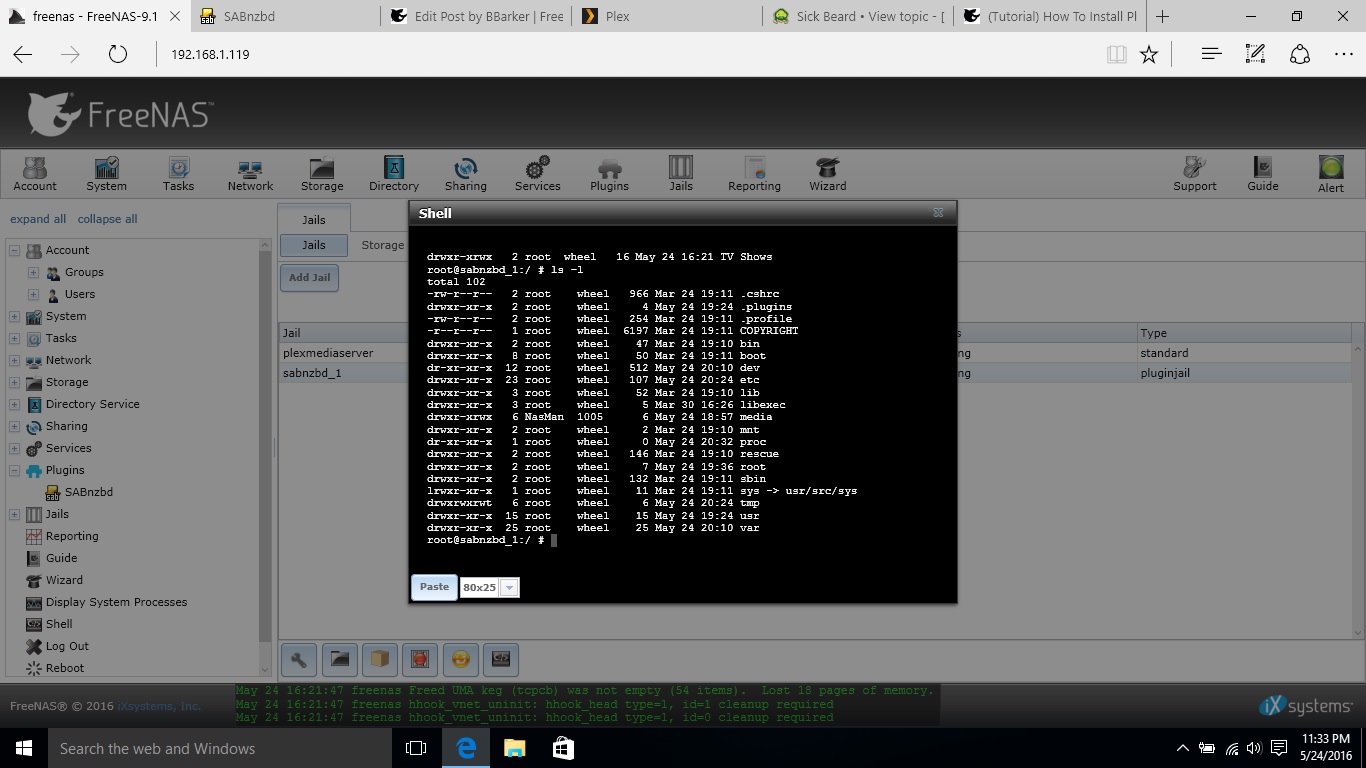

I feel like I may be chasing my tail a bit here. Sabnzbd is working but I can not get the plugin to turn on?
In the webGUI for Sabnzbd it has an error message: "Cannot access PID file /var/run/sabnzbd/sabnzbd.pid"
I thought I had my ownership setup properly:
When I try to start it using the jail webGUI it shows this error:

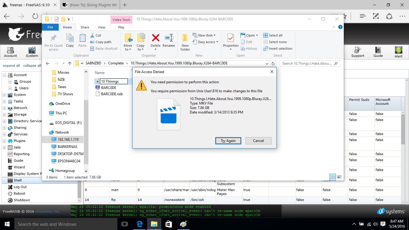

I have been able to download content, it unpacks it and deletes the .rar files and I am able to move the files about and use them fine.
Joshua Parker Ruehlig
Dec 5, 2011
5,949
Interestingly enough, when I did the plugin switch as described above and then applied solution one, Sabnzbd is running and while the plugin initially turned on, after configuring Sabnzbd and restarting it for the changes to take effect, the plugin is now off and will not turn on in the FreeNAS webGUI.
Can you try restarting the jail. maybe the freenas webui can make a fresh connection with the sabnzbd plugin's communication interface.
BBarker
Aug 7, 2015
120
I was thinking to leave well enough alone but I did try this with the only result being that Sabnzbd is now stopped and I can not get it to restart, no change in the webGUI...it still won't turn the plugin on:
root@sabnzbd_1:/ # service sabnzbd onestart
Starting sabnzbd.
su: pam_start: system error
/usr/local/etc/rc.d/sabnzbd: WARNING: failed to start sabnzbd
root@sabnzbd_1:/ # service sabnzbd start
Starting sabnzbd.
root@sabnzbd_1:/ #
