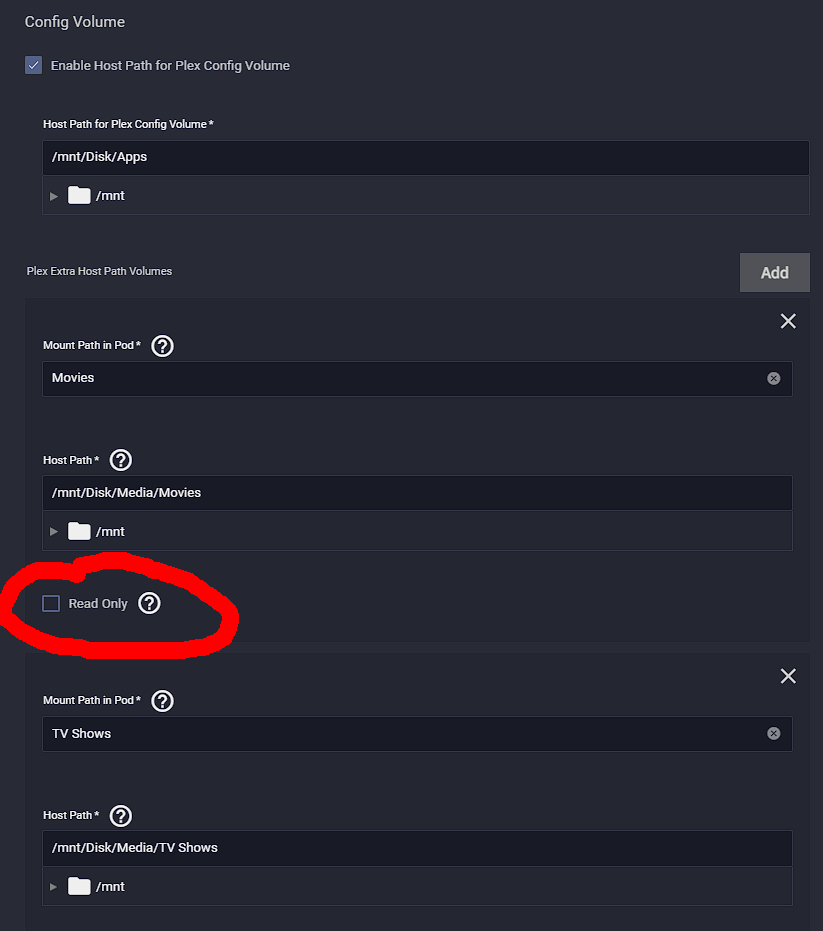

I realize it doesn't address the issue of "automatically changing the ownership", but will this not work?
(I don't use SCALE, so I cannot provide a more up-to-date screenshot.)

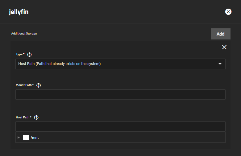

Jellyfin doesn't have the read-only mount option at present for additional storage.

It is Jellyfin from the official (iX) charts repo. And in the current version there's no read-only checkbox in the app's config settings, as someone mentioned before...
Yeah, that I had seen ;) But e.g. emby does, from what I recall. Would it be possible to allow that here too? Just asking for the general public, as what I wanted Jellyfin to do it isn't capable of, and currently, I have no luck of even getting any response at all from their dev team regarding that feature and its possible implementation. So, Jellyfin is dead to me anyhow, for the time being.
