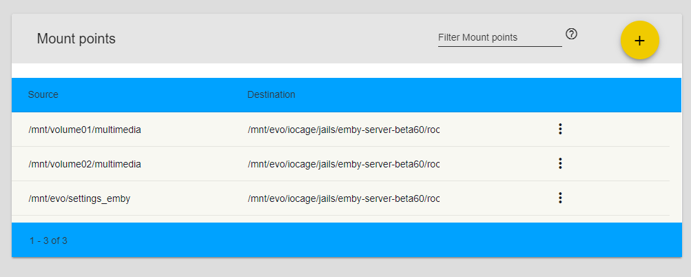

YOu can use the GUI to mount your datasets to the installation. I typically install emby via CLI and add the mount via GUI.
Stop the jail, hit the 3 dots, click add mount points.
similar to the image View attachment 26438
Thank you for your response this is how i did it and the 2 lines i wrote correspond to the input you show yet to no avail
