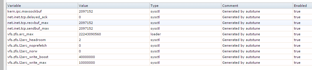

Attached is a screenshot of the variables it set - any comments (especially obvious problems) most appreciated. My main concern is to max out the ARC as this system has limited # of drives available to it. As it's not yet heavily used, it took about a week to fill up the arc. This is why I noticed that it was approaching full utilization the day before it died.

It depends on the philosophy you go by.
Autotune was originally intended to prevent ZFS memory runaway where ZFS would slowly but surely consume more and more RAM until there was no more. Then it would try to consume even more RAM resulting in "bad things".
It does that pretty well on TrueNAS servers. The thing is that TrueNAS servers are often storing data that keeps a business operating. Downtime means money lost and it's better to limit your RAM for ZFS to an arbitrarily lower number than 'all of your RAM' to ensure nearly 100% uptime.
On the flipside FreeNAS servers are rarely in production environments where they would be susceptible to such problems. TrueNAS servers already have lots of RAM (48GB is the smallest I've seen on any TrueNAS server), yet we rarely see 48GB of RAM in the forums.
Different user-base, different hardware-base, different intent, and different consequences of downtime.
There is nothing stopping you from setting it, but for FreeNAS users the autotune is often overly cautious to the point of hurting performance and making the server unstable. If you look at the autotune code it does something like "X GB of RAM in the system, subtract X % and make that the vfs.zfs.arc_max". It might be a raw number like 10GB (I forget which). But ultimately the % is insignificant at small amounts of RAM (like 16-32GB), but is hugely overkill if it's a raw number.
So use the right tool for the right job.
To add to this conversation, autotune sets some other values that seem to be "better" for today's hardware but aren't the default in FreeBSD. Note that the settings may not be ideal for all situations, and in some cases hurt performance. If you look at the code and read up on the parameters and do your own tests you can decide for yourself what you want to use.
There is no secret magic sauce that Autotune does that a sufficiently educated ZFS guru can't prove will help or hurt performance/stability. It's just a matter of whether it applies to you. Autotune is useful for TrueNAS servers which are often underpowered and overworked because businesses almost always buy less than they need and then try to make the hardware do what they want. At home, spending just $300-400 on RAM will give you an overpowered home system that can't possibly be "overworked" without you taking significant effort to "overwork" it. For businesses the cost is quite a bit higher. DIMMs that are >8GB in density can get exponentially more expensive.
As for your exact case I can provide zero evidence as to whether any of those are good or bad. It's very much dependent on your server, it's workload, it's strengths and weaknesses, etc.
