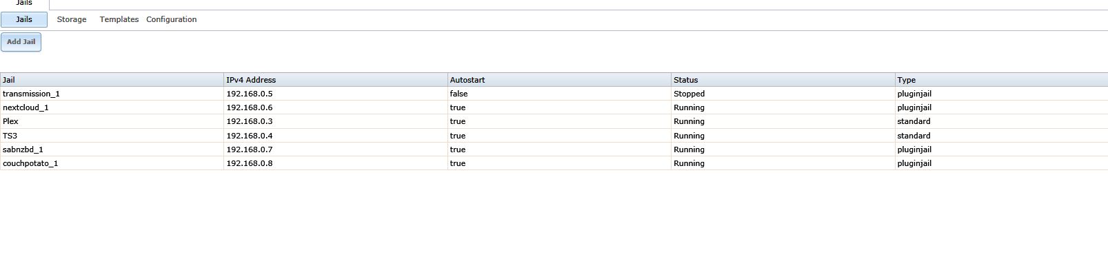

What about your network switch? How is your NAS connected to the rest of your network?
kdragon75
Aug 7, 2016
2,457
Try disabling all of your jails auto start, makesure you NAS is only connected by one cable and see if that makes a difference.
kdragon75
Aug 7, 2016
2,457
Are your jails using 192.168.0.9 & 192.168.0.2?
JamesWorts
Apr 29, 2017
17
Nope.
I can disable autostart and reboot, see if that solves it, but I would need to fix this, cant be having to manually start each one.
