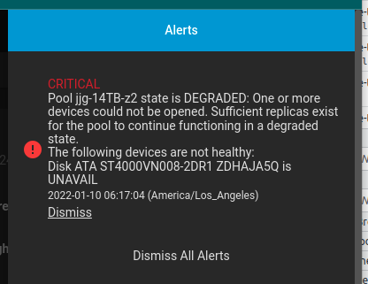

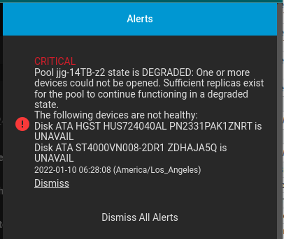

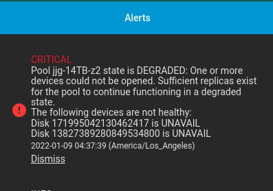

I unplugged 2 disks and got this error message.
But these serial numbers do not match the serial numbers when all disks are attached.

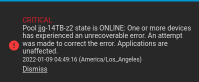

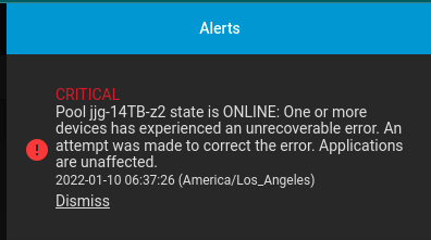

Also, an alert appeared after I inserted saying something did not recover.

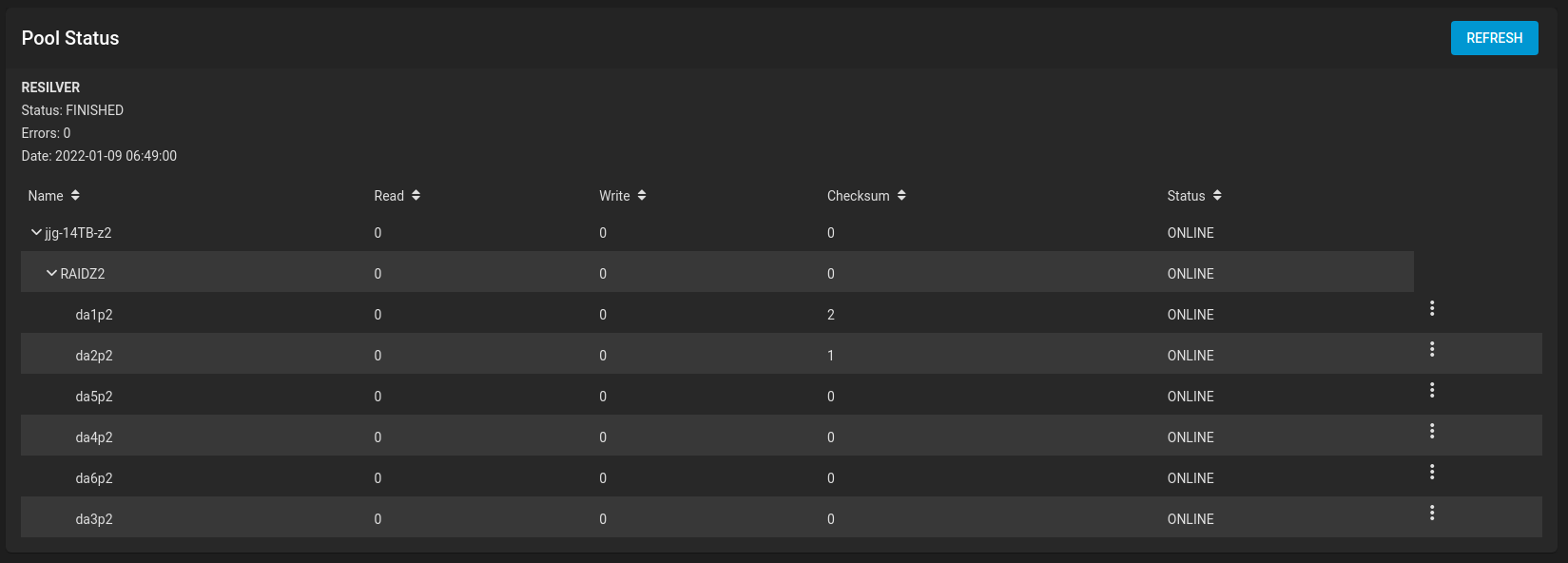

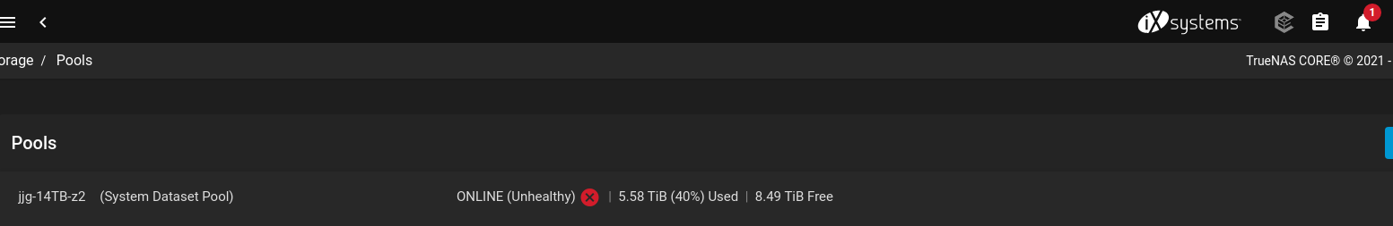

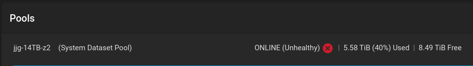

Also my pools show an alert.
Question 1: How do I convert the serial number in the disk failure alert to the serial numbers displayed in the disk window?
Question 2: How do I clear the red x in the pool window or do I still have a problem? Are the checksum because I disconnected the disk or does it mean something really got messed up when I disconnected my disk for the experiment?

I am confused as whether or not there is even an issue. A red x in the Pools tab, and pool status show 2 checksums of 2 and 1 are the only anomalous indication of something not right. I assume that if I'm 1 disk failure away from total data loss there would be more "in your face" alarms.

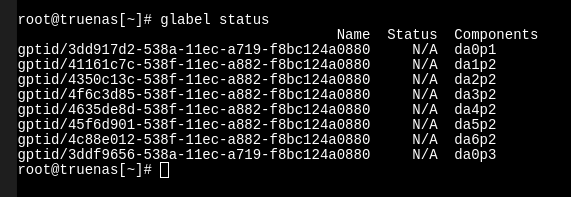

glabel status
will get you a list of drive identifiers and their GPTID's. From this you can match the affected diskd to their serial numbers and find them in your system.

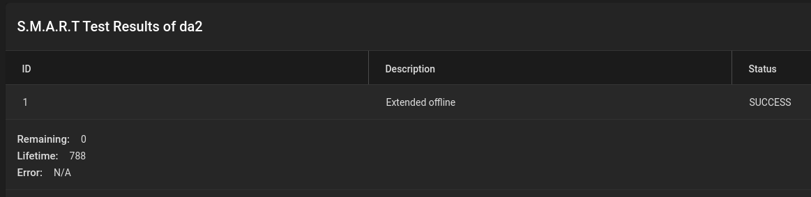

The web GUI reports both smart test as success.
Pool still shows Unhealthy
At this point, not sure if the Unhealthy x is real or not. I would appreciate someone with experience commenting.

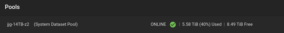

Tried a reboot and the unhealthy icon disappeared.
Wow, you are a trove of information. Thanks.
These # do not match with the first alert dialog.
I tried converting 3dd917d2 from hex to decimal but that does not match either.
Yes, I noticed that after I posted - I have no idea what those numbers are that appeared in that first error message.
BTW - are you using TrueNAS Core or Scale - don't think you said and I didn't ask. I know nothing about Scale...
You didn't give us your system info yet - do you have a hot-plug drive arrangement? When you unplugged your drives (as your first post says) were they running or was the server powered down?
9,700
Those are the ZFS partition guids... I think you can look at them with zdb -l /dev/da1p2, but I would not recommend doing that if you didn't already know about it, it's unlikely to be helpful as it's really only displayed when the disk is offline anyway.
If you run that on a pool member disk (data partition), you see that it has information about the other members of its VDEV and a little about the pool.
It's not really helpful to humans though.
Thanks for the info - "learning never ends"!
I wonder why the Error Message displays that info instead of the disk guid.

I repeated the experiment, but only 1 drive powered down, and a different drive.
It now displays the serial number in the alert, not like yesterday.
Now with 2 drives down, again different drives from yesterday. I get serial numbers, not like yesterday.

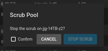

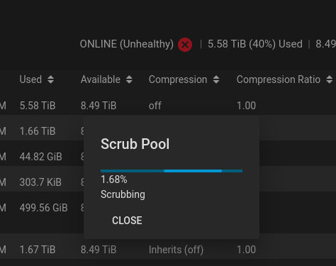

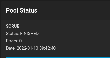

The GUI blanked out, so I re-logged, but the pool window does not show scrub still running.
Maybe it was completed way faster than predicted, so I started another and got this message.
So obviously scrub is still running.
Was there an indication somewhere in the GUI I just missed or is the user expected to try to run it again to see if it is still running?
Where will the scrub results appear?
Jessep
Aug 19, 2018
379
Shell
Run command "zpool status"
jgreco
Resident Grinch
May 29, 2011
18,680
Well this is actually a very good question. I'm reasonably positive the GUI used to indicate this somewhere. I just checked one of our filers known for "the long scrubs" and while it is clearly doing a scrub as indicated from the CLI, I am not seeing an indication of this in the GUI. Perhaps I am just not yet fully awake this morning...?
9,700
It's there if it was the last run activity on that pool...
jgreco
Resident Grinch
May 29, 2011
18,680
Yeesh, that's buried. But you're right, it's there if you dig.

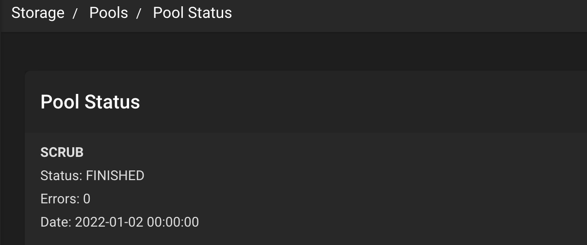

john60
Nov 22, 2021
85
yes, I found it now. For me it reports the scrub as zero errors.
But it is interesting that a critical alarms remains even though the disk were plugged back in
and still the red x
I logged out of the GUI and logged back in but these alarms remain.

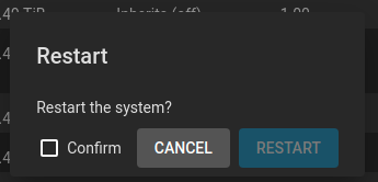

Yesterday a restart of truenas core cleared the red x. So I did a restart again today.
and now the red is gone just like yesterday
So it would appear that if a power down, remove disk, power up see alarms, power down, put back disk, you will get a red x, scrub, x remains, and another reboot is required to clear the red x.
Is this 2 bugs or does Truenas really require a 2nd reboot to clear the 'red (unhealthy) x' in the Pool window and sometime reports funky serial numbers?
