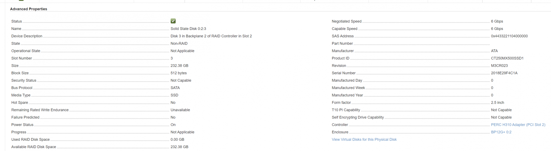

When i look in iDRAC for these disks, it is able to tell me the serial numbers. The serial numbers displayed in iDRAC are unique between the 6 SSD's

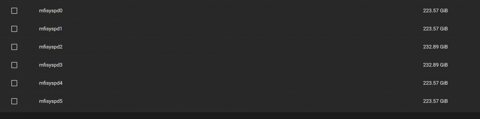

[EINVAL] pool_create.topology: Disks have duplicate serial numbers: '' (mfisyspd0, mfisyspd1, mfisyspd2, mfisyspd3, mfisyspd4, mfisyspd5).
The TN GUI lists these SSD as mfisyspd0-5 with a blank serial number.
This suggests that your disks are hooked up to a RAID controller. Please see
LSI cards can have several different modes. MFI is the old MegaRAID SAS controller driver, and this is not acceptable for TrueNAS.

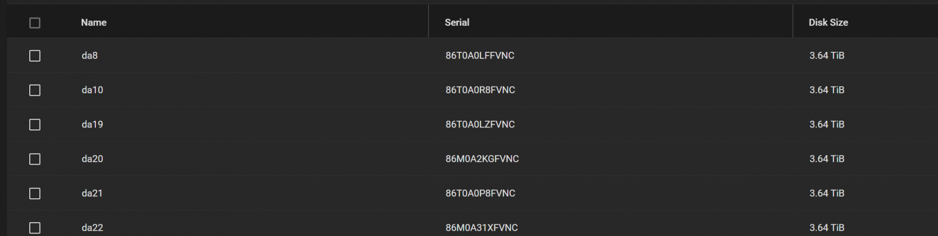

The H830 however, does have a HBA mode option: https://www.dell.com/support/manual...cc87e1-d534-451a-9947-56f1175886c5&lang=en-us
This is how my MD1400 is connected (and daisy chained to the 2nd one) and is working fine. These disks show up in TrueNAS as da10, da11, etc...

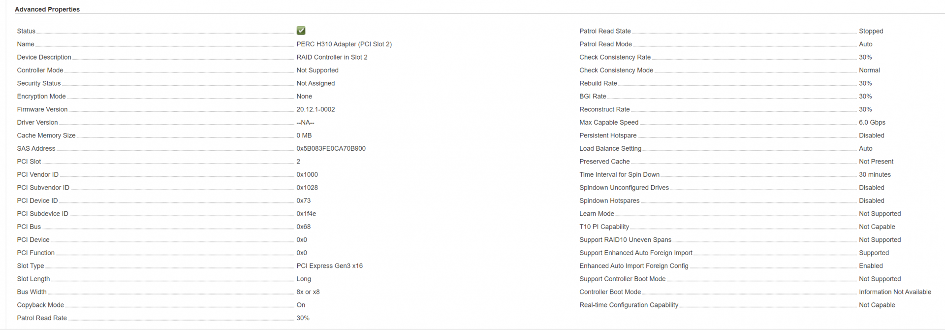

The Dell Perc H310 is "flashed to IT mode" according to the ebay article (2 years ago approx), so it should not support RAID at all. Here is the details of the controller

It's still running the Dell IR firmware. You'll want to push the official LSI IT firmware onto it for both stability and performance reasons (as the H310 is notable for having a very poor queue depth) and note that the "Mini/Mono" proprietary adapter cards require a different flash process from the full-size PCIe ones.

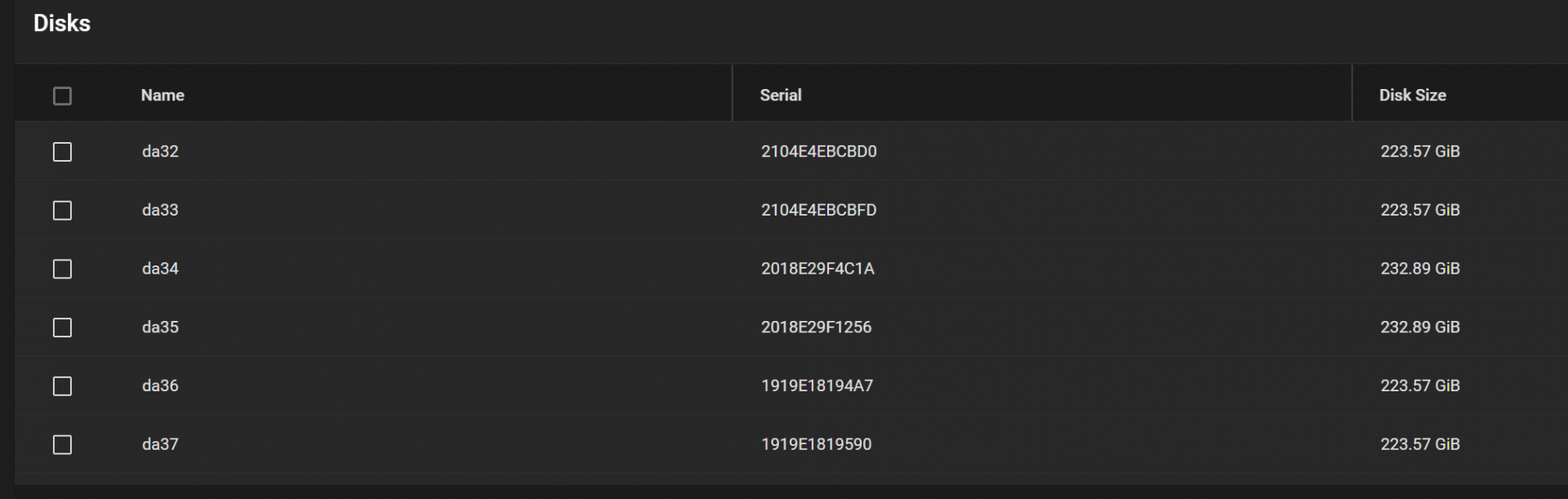

Flashed another H710 also, which tested ok. I will need to swap it for the one in this system sometime, but it will likely ruin my boot and temp pool.

For what its worth, if anybody comes across this thread later, the raid disks on the H710P Mini were not toast. they did load back up just like before.
Obviously i cannot guarantee it will be the same situation for others specific situation. Mine were single-disk Raid-0's
in my case, I did choose to blow it away and rebuild the pool anyway. it was only temp data stored there anyway.
