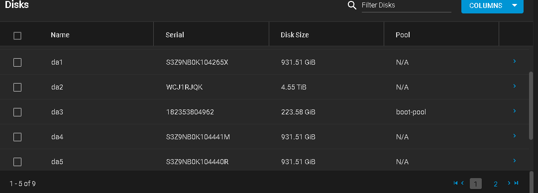

Folks, I just opened PERC bios and set it to NON-RAID, booted into windows and I was able to see disks.
Now I am installing TrueNAS Core 13 to test it.

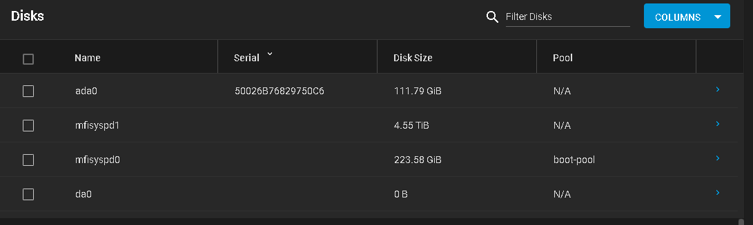

sekroots
Feb 28, 2022
61
Here is my current dmesg:

mfi0: <Drake Skinny> port 0xfc00-0xfcff mem 0xdf1bc000-0xdf1bffff,0xdf1c0000-0xdf1fffff irq 40 at device 0.0 on pci4
mfi0: Using MSI
mfi0: Megaraid SAS driver Ver 4.23
mfi0: 17158 (707499313s/0x0020/info) - Shutdown command received from host
mfip0: <SCSI Passthrough Bus>mfi0: 17159 (boot + 3s/0x0020/info) - Firmware initialization started (PCI ID 0073/1000/1f78/1028)
mfi0: 17160 (boot + 3s/0x0020/info) - Firmware version 2.120.14-1504
mfi0: 17161 (boot + 5s/0x0020/info) - Package version 20.10.2-0002
mfi0: 17162 (boot + 5s/0x0020/info) - Board Revision A00
 on mfi0
mfi0: 17163 (boot + 3s/0x0020/info) - Firmware initialization started (PCI ID 0073/1000/1f78/1028)
mfi0: 17164 (boot + 3s/0x0020/info) - Firmware version 2.120.14-1504
mfi0: 17165 (boot + 5s/0x0020/info) - Package version 20.10.2-0002
mfi0: 17166 (boot + 5s/0x0020/info) - Board Revision A00
mfi0: 17167 (boot + 36s/0x0002/info) - Inserted: PD 04(e0xff/s4)

mfisyspd0 on mfi0
mfisyspd0: 228944MB (468877312 sectors) SYSPD volume (deviceid: 4)
mfisyspd0:  SYSPD volume attached
uhub0 on usbus1
uhub0: <Intel UHCI root HUB, class 9/0, rev 1.00/1.00, addr 1> on usbus1
ugen2.1: <Intel EHCI root HUB> at usbus2
ugen0.1: <Intel UHCI root HUB> at usbus0
uhub1 on usbus3
uhub1: <Intel UHCI root HUB, class 9/0, rev 1.00/1.00, addr 1> on usbus3
ipfw2 (+ipv6) initialized, divert enabled, nat enabled, default to accept, logging disabled
ipmi0: IPMI device rev. 0, firmware rev. 2.85, version 2.0, device support mask 0xdf
ipmi0: Number of channels 5
ipmi0: Attached watchdog
ipmi0: Establishing power cycle handler
mfisyspd1 on mfi0
mfisyspd1: 4769307MB (9767541168 sectors) SYSPD volume (deviceid: 5)
mfisyspd1:  SYSPD volume attached
mfi0: 17168 (boot + 36s/0x0002/info) - Inserted: PD 04(e0xff/s4) Info: enclPd=ffff, scsiType=0, portMap=01, sasAddr=44332211030ugen4.1: <Intel UHCI root HUB> at usbus4

sekroots
Feb 28, 2022
61
It is using mfi driver.
Patrick M. Hausen
Nov 25, 2013
7,776
Don't use the controller this way. You must flash it with a special IT mode firmware. Merely enabling "NON-RAID" won't work.
And please enclose this long dmesg output in "CODE" tags like so:
This
is
code
Thanks!
sekroots
Feb 28, 2022
61
I guess I got it.

da0 at mps0 bus 0 scbus0 target 2 lun 0
da0: <ATA Samsung SSD 860 2B6Q> Fixed Direct Access SPC-4 SCSI device
da0: Serial Number S3Z8NB0KC88772L
da0: 600.000MB/s transfers
da0: Command Queueing enabled
da0: 953869MB (1953525168 512 byte sectors)
da1 at mps0 bus 0 scbus0 target 3 lun 0
da1: <ATA Samsung SSD 860 1B6Q> Fixed Direct Access SPC-4 SCSI device
da1: Serial Number S3Z9NB0K104265X
da1: 600.000MB/s transfers
da1: Command Queueing enabled
da1: 953869MB (1953525168 512 byte sectors)
da4 at mps0 bus 0 scbus0 target 6 lun 0
da4: <ATA Samsung SSD 860 1B6Q> Fixed Direct Access SPC-4 SCSI device
da4: Serial Number S3Z9NB0K104441M
da4: 600.000MB/s transfers
da4: Command Queueing enabled
da4: 953869MB (1953525168 512 byte sectors)
da5 at mps0 bus 0 scbus0 target 7 lun 0
da5: <ATA Samsung SSD 860 1B6Q> Fixed Direct Access SPC-4 SCSI device
da5: Serial Number S3Z9NB0K104440R
da5: 600.000MB/s transfers
da5: Command Queueing enabled
da5: 953869MB (1953525168 512 byte sectors)
da3 at mps0 bus 0 scbus0 target 5 lun 0
da3: <ATA WDC WDS240G2G0A- 0000> Fixed Direct Access SPC-4 SCSI device
da3: Serial Number 182353804962
da3: 600.000MB/s transfers
da3: Command Queueing enabled
da3: 228944MB (468877312 512 byte sectors)
da7 at umass-sim2 bus 2 scbus5 target 0 lun 0
da7: <SanDisk Cruzer Blade 1.00> Removable Direct Access SPC-4 SCSI device
da7: Serial Number 03047120100520184640
da7: 40.000MB/s transfers
da7: 14955MB (30629376 512 byte sectors)
da7: quirks=0x2<NO_6_BYTE>
cd0 at umass-sim1 bus 1 scbus4 target 0 lun 0
cd0: <iDRAC Virtual CD 0323> Removable CD-ROM SCSI device
cd0: 40.000MB/s transfers
cd0: Attempt to query device size failed: NOT READY, Medium not present
cd0: quirks=0x10<10_BYTE_ONLY>
da6 at umass-sim0 bus 0 scbus3 target 0 lun 0
da6: <iDRAC LCDRIVE 0323> Removable Direct Access SCSI device
da6: 40.000MB/s transfers
da6: Attempt to query device size failed: NOT READY, Medium not present
da6: quirks=0x2<NO_6_BYTE>
da6: Write Protected
da2 at mps0 bus 0 scbus0 target 4 lun 0
da2: <ATA ST5000LM000-2AN1 0001> Fixed Direct Access SPC-4 SCSI device
da2: Serial Number WCJ1RJQK
da2: 600.000MB/s transfers
da2: Command Queueing enabled
da2: 4769307MB (9767541168 512 byte sectors)

Thanks @Redcoat .
From experience, this doesn't work right. You might be able to run it, but you will likely run into hot swap issues. Far better to just flash it to the LSI firmware.
sekroots
Feb 28, 2022
61
Hello @firesyde424 ,
I just flashed it and it is working like a charm but we intend to provide HA storage using 2 TrueNAS nodes running at Dell PowerEdge R610 ( with PERC H310 IT mode enabled) but we are still researching for a good solution. We also installed TrueNAS Scale at VMs to see it working.
