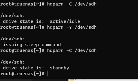

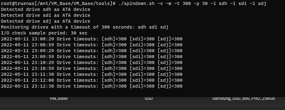

i tested the new script for Scale, its running but not spinning down the Drives.
I know that running Drives are mostly better, but i always have some Movie Lib. Drives wich are running only one Times a week for one hour... .
Manual with hdparm -y its working.
The scripts runs but never trigers. (the timers are set low for testing)
Actually what you made obvious between that statement and the screen capture (lower and uppercase Y respectively) is that the lowercase y doesn't cut it.
I updated the script on the Git repo (or just edit line 225 to be uppercase Y) and give that a shot.

@NugentS Drives are empty and only put in for testing
@sretalla nothing changed with -Y, still no spindown
there are also some other Stuff. hdparm seems a little bit picky
