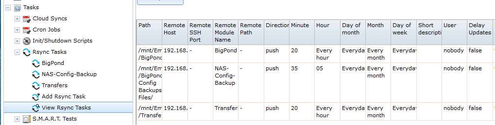

It is for this reason that when I setup my two FreeNAS systems at home, I just used rsync
and do a file copy from one directory to another. I can access the files, as files, on either system when I need to without having to make any changes. I still have snapshots on the main system so I can mount an older point in time to go back and get something if I change it by mistake or delete a file by my own error and it has been long enough that the rsync already happened. The advantage (to me) of having two fully online copies of the data is that if I have to take a system down for maintenance, the data is still available on the other system and that is a nice thing.
