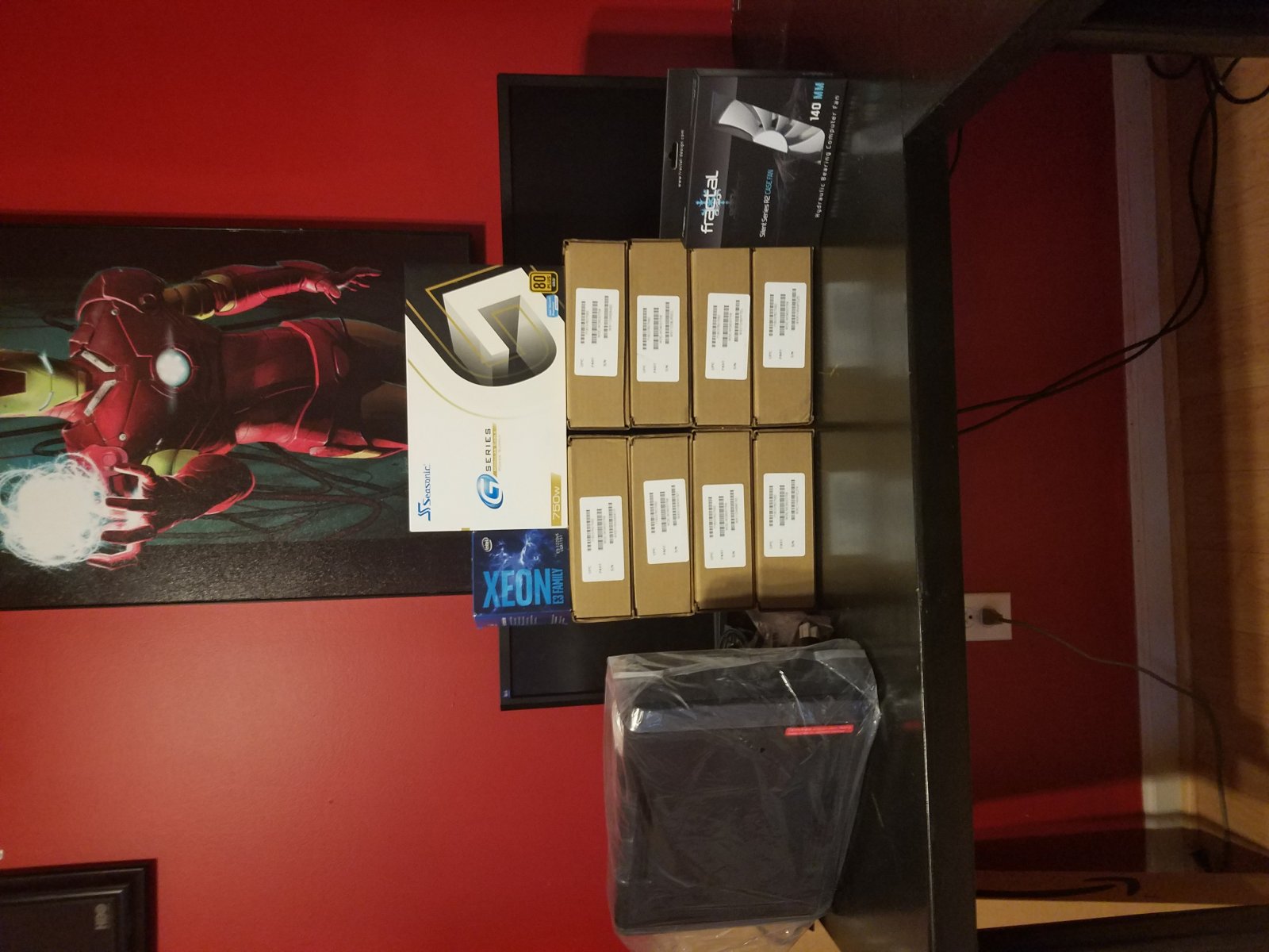

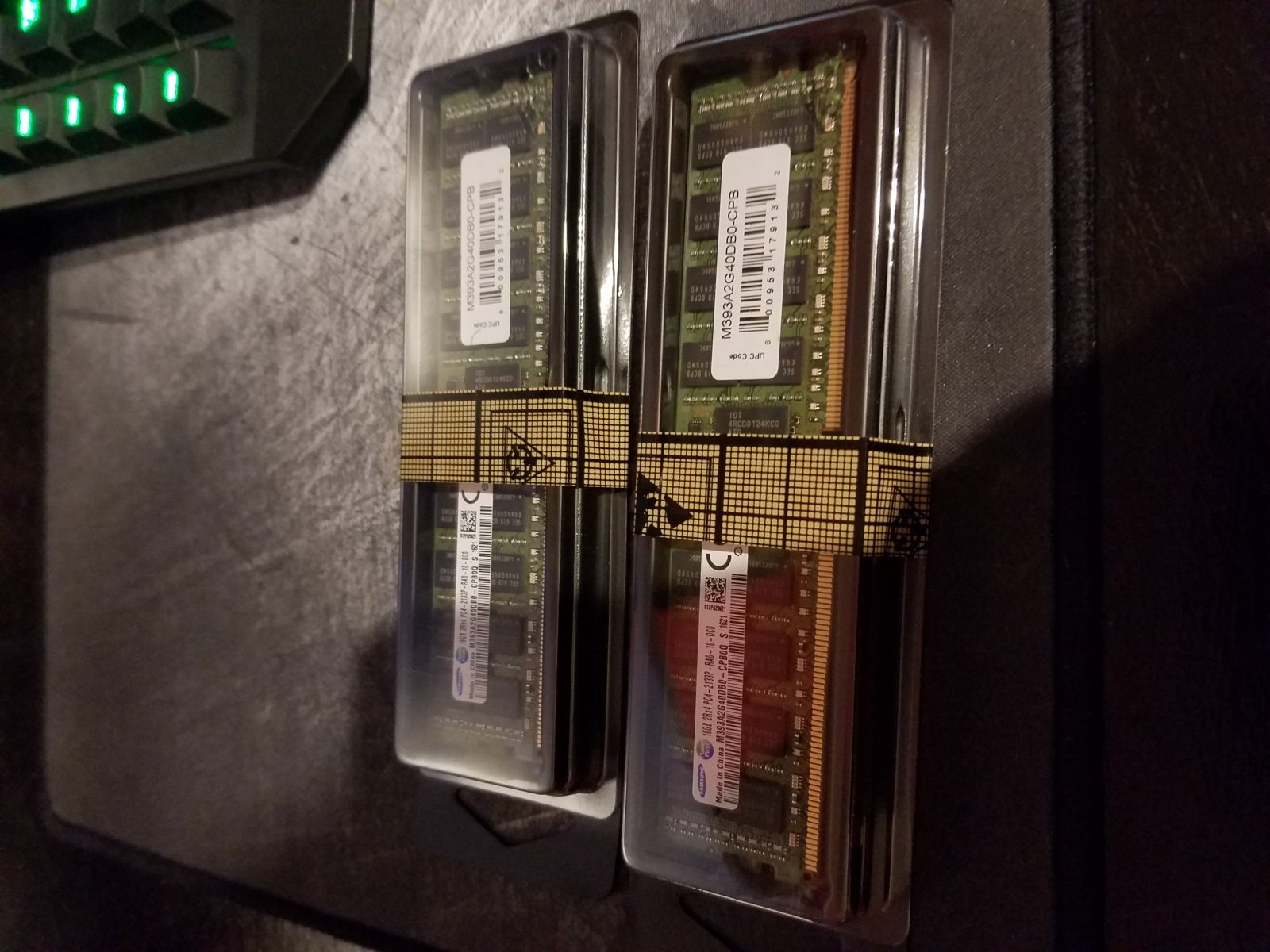

Parts are coming in, woot. Just waiting on the motherboard and case and sata cables and they get here Monday.
Question though, with 8x6tb drives, I read ZFS prefers 1gb of RAM per 1tb of storage. Is that usable storage or raw storage? Should I get another couple sticks of my RAM to max out my board at 64gb or should 32gb be fine for now?
The answer is "yes".
It's a rule of thumb, not an absolute rule. 32GB will probably be plenty. If not, add more RAM later.
