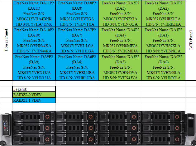

I have a question. The motherboard I will be using has 8 SATA ports. I want to connect 10 drives in total. Am I able to connect 8 drives via SATA and then get an HBA and connect the remaining two through PCI-e? Would that not cause any issues?
Nope, as long as FreeNas can get direct access to the drives then it really doesn't care which route it takes (one of the beauties of FreeNas). Only suggestion I would make is to know where each drive is located (physically attached). That way if you get a notification that two drives have failed from your RaidZ3 you can reference your document(s). It may turn out that those two "failed drives" are the ones attached to the HBA. In that case, it may just be the HBA itself instead of the two drives.
Example of an old "Hard Drive Matrix" of mine is in the attached image.
