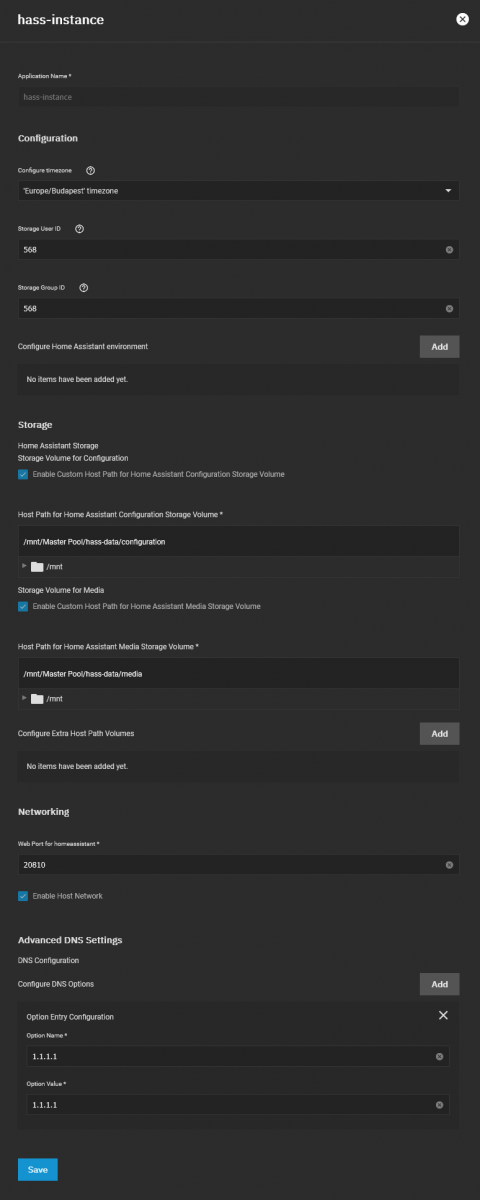

I can't seem to get the new Home Assistant application to work on TrueNAS Scale, if it has the Host network option enabled.
I have tried:
- Updating to the latest version of SCALE,
- Re-making the application,
- Adding DNS servers to the application config,
- Refreshing the application catalog,
- Reinstalling TrueNAS
Non of the above have fixed the issue, it always just says Deploying 1/2.

9,700
Do you really need to set the advanced DNS settings?
Seems HA is throwing an error about too many DNS.
varma01
Jun 8, 2022
I reduced it down to two DNS servers, but it still doesn't work... The DNS errors are gone tho.

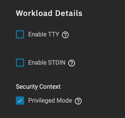

I am running the Docker-Hub version - not the TrueCharts one.
I have "privileged mode" enabled:
And in the ha-config:
# Custom Switches
switch:
# WOL - Workstation
- platform: wake_on_lan
mac: "04-***"
host: 192.*** #ip of target machine
broadcast_address: 192.*** #ip of target machine
broadcast_port: 9
turn_off:
service: script.workstation_shutdown
The weird behaviour is .. I am able to remotely WOL the machine but only when it was on recently (like the last few minutes).
After a couple of hours it does not wake up. When I send the WOL package from my Mac miniWOL app it works every time though...
