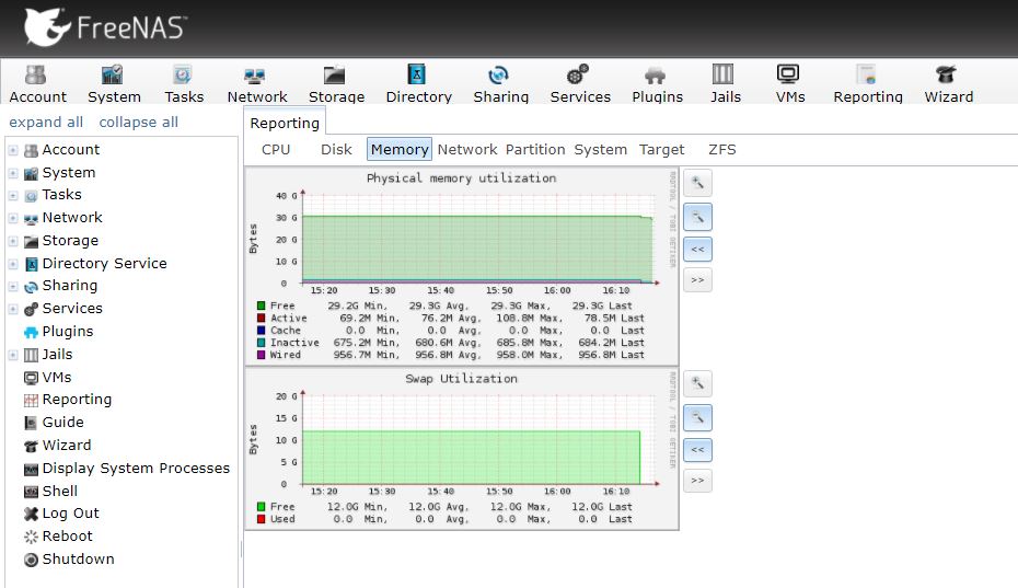

Incidentally while we are discussing this kind of thing. My server is limited to 16gb of ram which is almos 100% utilised by the OS.
Please post a screeshot of the GUI (like mine below)
This is the way FreeNAS/FreeBSD works, it will consume all your RAM and use it for an ARC. This is normal. Rarely or after a reboot you will see less utilization of your RAM but it will get used up the more you use your system and data can be cached into the ARC. What you do not wan to see is the SWAP file being used, this is how you know that you have a low memory issue. A small amount of swap usage is fine but if you are using more than a few megabytes and are using it constantly, then you have a RAM shortage. The swap file is used to keep the system running, not to be used to make up for low memory.
