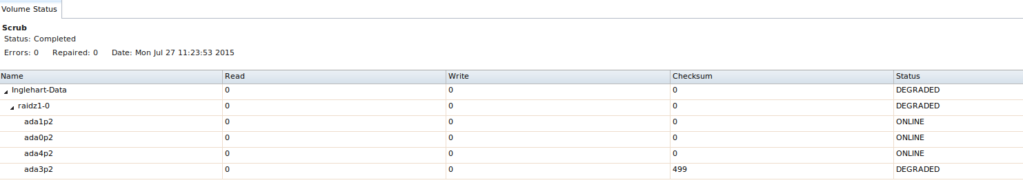

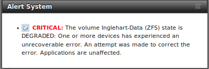

I am relatively new to FreeNAS. Today I got my first error. Can someone let me know, do I need to replace the disk or should I be doing something else to verify if it is a HW failure.

Odds are you will have to replace a hard drive. Because you have a RAIDZ1 I'd recommend that you backup any critical data to an external device/computer.
Next provide the output of "smartctl -a /dev/ada3".

That does look fine. Now for completeness do it for all your other drives. If you have no issues do the following...
1) Shut down your FreeNAS.
2) Open the case and unplug and then plug in the SATA cables on the drives and the motherboard.
3) Close it up and power on.
4) Check your volume status again if you have a failure you need to fix it.
5) Run a scrub if you don't see any errors.
5) Report your results.
The reason for reseating the SATA cables is this is a possible failure, even a bad SATA cable could occur, it happens. I'm not saying a FreeNAS Mini is made with substandard parts, sometimes you can't avoid it no matter who builds it. Maybe it's nothing as well.
I may not be around when you finish this up today but if you run into some issue, others can offer further advice.
Hey, what version of FreeNAS are you running? Don't rule out a bug either if this is the new release, but it's unlikely, just possible too.
-Joe

Followed your suggestions. After I completely cold shut it down and rebooted, everything came back clean. The Alert is green now and the volume is now reported as healthy. I will continue to monitor.
