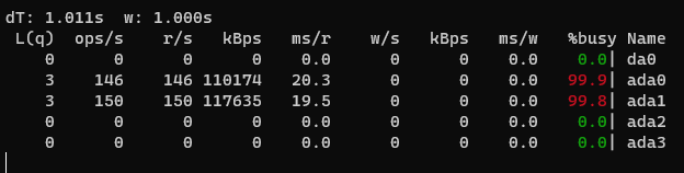

Assumptions: All of your three drives are identical models. If we need to play with the partition sizes I'll need to do more.
In the examples below:
ada0 is "Drive A" that got the Proxmox wipe.
ada1 is "Drive B" that we thought failed, but it was just loose cabling and it's now recovered.
ada2 is "Drive C" that's the last disk standing.
You can see from ada1p2 that the last transaction group committed was 2025670 and ada2p2 is 2083363 - assuming you basically hovered around the 5-second default txg timeout period that's around 80 hours.
Confirm with serial numbers that the order of these drives hasn't changed.
So, step zero is underway - clone Drive A to Clone A.

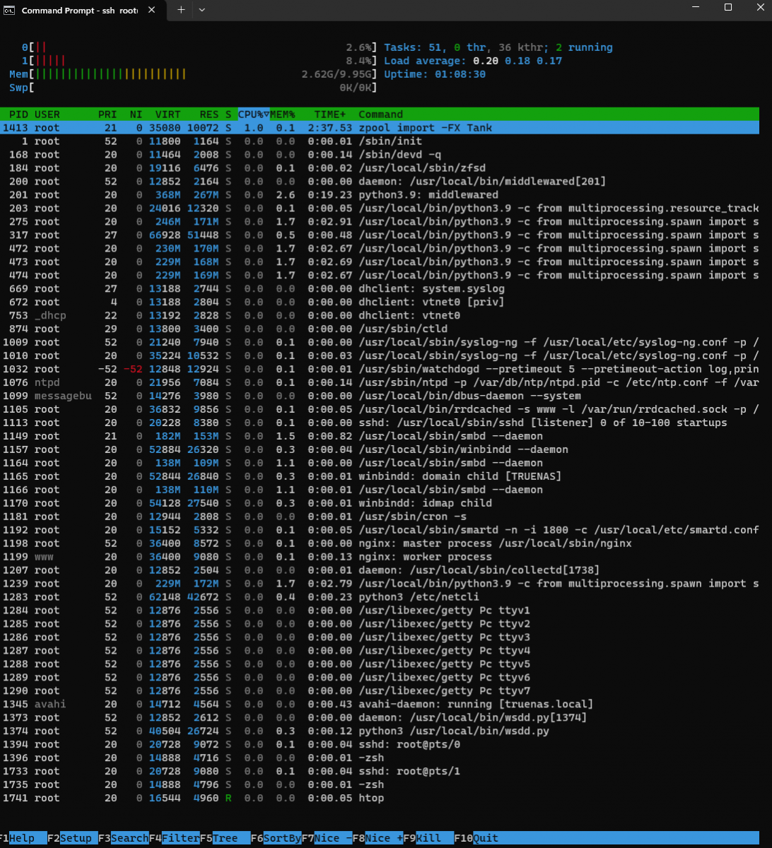

I continued to follow your steps in the instructions and here's our next roadblock:
root@truenas[~]# zdb -l /dev/ada0p2
LABEL 0
    version: 5000
    state: 0
    txg: 2083363
    pool_guid: 2717787786726095806
    errata: 0
    hostid: 1361597103
    hostname: ''
    top_guid: 12486228298157547035
    guid: 2470301540868142256
    vdev_children: 2
    vdev_tree:
        type: 'raidz'
        nparity: 1
        metaslab_array: 74
        metaslab_shift: 34
        ashift: 12
        asize: 11995904212992
        is_log: 0
        create_txg: 4
        children[0]:
            type: 'disk'
            path: '/dev/gptid/11b39573-ad95-11ed-8d1c-7df9cea98351'
            DTL: 48182
            create_txg: 4
        children[1]:
            type: 'disk'
            guid: 3459701388371009720
            path: '/dev/gptid/11bac542-ad95-11ed-8d1c-7df9cea98351'
            not_present: 1
            DTL: 48181
            create_txg: 4
        children[2]:
            type: 'disk'
            guid: 16273966696595496550
            path: '/dev/gptid/11c0215d-ad95-11ed-8d1c-7df9cea98351'
            DTL: 48180
            create_txg: 4
    features_for_read:
        com.delphix:hole_birth
        com.delphix:embedded_data
    labels = 0 1 2 3
root@truenas[~]# gpart modify -i2 11b39573-ad95-11ed-8d1c-7df9cea98351 ada0
gpart: Invalid number of arguments.
root@truenas[~]#
The
command is incomplete.

All looks good, had to do zpool import -FX otherwise I'd get i/o errors. It's been importing for 20ish mins now. Does this process usually take some time? I can see it's using some CPU and definitely reading the disk a lot even now, so it's definitely not just doing nothing.
HoneyBadger
actually does care
Administrator
Feb 6, 2014
5,112
I imagine it will take some time to go through and determine what needs to be done here to get a valid pool state. Open a second SSH session and run gstat -p to see what the disks are doing as well as top or htop to see what the highest CPU process is.
HoneyBadger
actually does care
Administrator
Feb 6, 2014
5,112
With it doing 100% reads from ada0+ada1 (ada2 is cache, ada3 is log?) I'd suggest that the best course of action is to let it continue. I can't really tell you how long it will take, but at 100MB/s it would take around 11-12 hours to walk a full 4TB disk. If the disks aren't full, then it could be less time.
