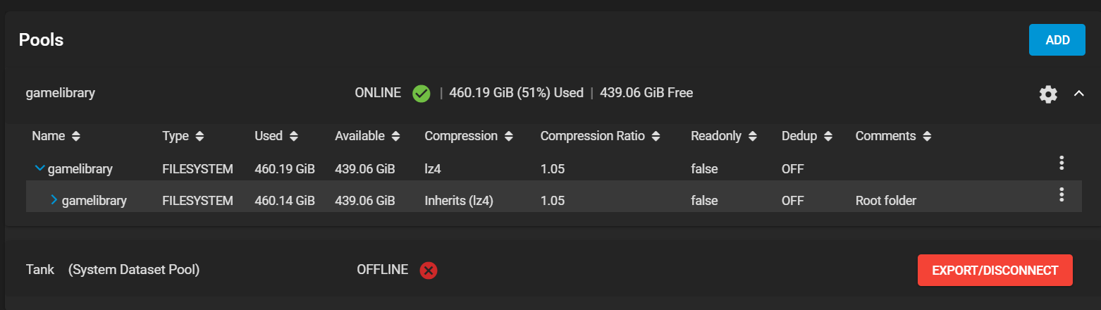

Dawson
Jun 17, 2023
80
Turns out the drive didn't fail. There's still hope! So it's back in TrueNAS. The pool says unavailable. How do I get it back? I appreciate your help.
I believe that ZFS is not convinced that the disks are all available without conflict because one of the disks appears to be active on "another" ZFS system (which may just be your existing ZFS system but some hours ago).
It seems to think that a forced import could be successful. That's probably what I'd try. From the command line, try
zpool import -Fn Tank
which should indicate whether or not ZFS thinks a forced import will work. This is somewhat more accurate than just the status output message.

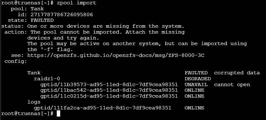

Dawson
Jun 17, 2023
80
I tried the command, it finished with no output. Pool still unavailable and "zpool import" still shows the same. What next?
jgreco
Resident Grinch
May 29, 2011
18,680
The one that shows unavailable is the one I formatted by accident.
Is it actually there in the TrueNAS VM? You haven't indicated whether this is TrueNAS CORE or TrueNAS SCALE.

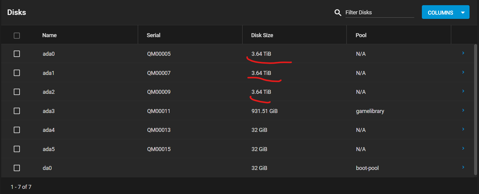

Dawson
Jun 17, 2023
80
Yes, the drive is showing. This is TrueNAS core. The 4tb drives are all the old hard drives. while the New one is sitting right next to me, unplugged.

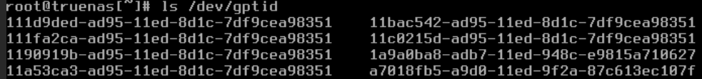

My guess is that there is something it doesn't like about the disk beginning with GPTID 11b39573. Does /dev/gptid/11b39573* exist if you look for it from the UNIX shell? Like maybe not even being there?
Dawson
Jun 17, 2023
80
How would I look for that?

jgreco
Resident Grinch
May 29, 2011
18,680
It's not there in your list. So that's what ZFS is mad about. It wants to see all its disks or it doesn't like it. I think you need to treat this as a failed disk replacement scenario. The manual has the proper current process for taking care of this.
