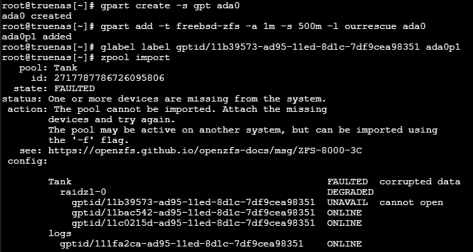

Maybe I am doing it wrong? But it doesn't look to have worked. zpool import -f Tank results in the same I/O error. Honestly, I am totally willing to send you a link if you want to remote-control my PC and mess with it yourself?
I appreciate the faith but that doesn't serve to show other people how to resolve their problems in the future, which is a large part of my goal in documenting steps and techniques here in the forums. It's some variation on the "give a person a fish/teach a person to fish" distinction, if I just solve your problem for you and the solution stays only in my head, what good is that?

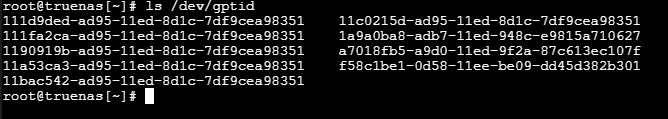

What I'm trying here is basically just stuff that is "right-ish" shaped to solve what might not be exactly right. This is computer stuff and computers like the details to be exactly right. The fact that we're still getting an UNAVAIL device suggests we got something wrong, so now that's curious enough to me that I'll see if I can figure THAT out. Just to make sure this is really the problem, please repeat our "ls" test from before over in /dev/gptid. Check
ls /dev/gptid/11b39573*
to see if it exists. In the meantime I'll run through the same steps you did. So here we have a disk da9;
root@nas4:/tmp # gpart create -s gpt da9
da9 created
root@nas4:/tmp # gpart add -t freebsd-zfs -a 1m -s 500m -l ourrescue da9
da9p1 added
root@nas4:/tmp # glabel label gptid/11b39573-ad95-11ed-8d1c-7df9cea98351 da9p1
root@nas4:/tmp # glabel list da9p1
Geom name: da9p1
Providers:
1. Name: label/gptid/11b39573-
   Mediasize: 524287488 (500M)
   Sectorsize: 512
   Stripesize: 0
   Stripeoffset: 1048576
   Mode: r0w0e0
   secoffset: 0
   offset: 0
   seclength: 1023999
   length: 524287488
   index: 0
Consumers:
1. Name: da9p1
   Mediasize: 524288000 (500M)
   Sectorsize: 512
   Stripesize: 0
   Mode: r0w0e0
Oh. Well that's not what we want. Mmm. Having now read through the documentation and looked at some code, it does not appear that there is a way to set the GPTID. That sucks.
Because it means we'd have to move on to somewhat more irreversible operations that I'm less familiar with. I think that this really needs to be made into ZFS's problem to resolve. My suggestion is to try "zpool import -F Tank" (note the capital F) and see if that works. My understanding is that this is supposed to work even with missing devices, but I don't generally have that issue on any of the pools here.
