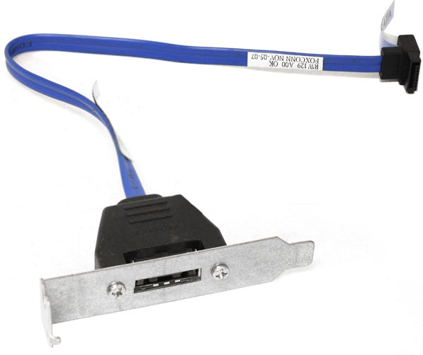

I appreciate the info, thanks! I do understand there will be risks, but again I'm not trying to write to any of these disks, in fact if I can block writes that would be best. These are backups only to be read. too bad it's not like the old days where I could move a jumper and hardware block writes to the drives.
I just realized I don't need to buy a cheap HBA for eSATA, there are two SATA motherboard connectors on that unit which aren't used with the integrated MINI MONO PERC and a SAS boot and storage array. I just need a couple of DELL XK064 cables to connect SATA to ESATA and I can use on-board BIOS support, hoping TNAS SCALE will support onboard SATA for nonboot operations. The port multiplier issue would still remain if I want to have more than 2 backups active at a time. That will require some testing to validate.
