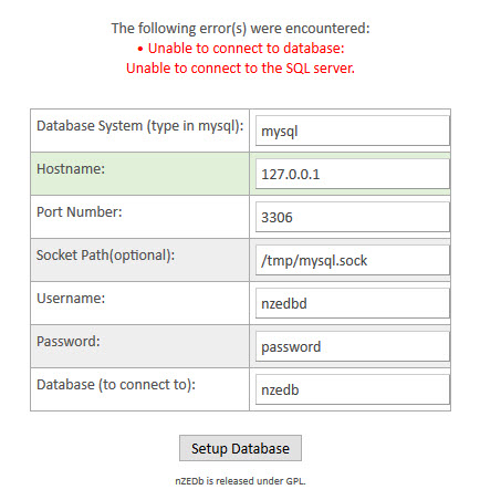

I noticed you updated the wiki page I referenced (thanks). The server now runs but I couldn't get past the database setup.

The error isn't related to the SQL user, looks like it might be related not being able to connect to mariadb.
Are you running mariadb and PHP in the same jail? if not, you probably shouldn't be entering anything for the socket.
I don't like how the guide has application not installed all in the same jail. It makes sense in some situations to have a central mysql server for multiple applications, but here it complicated things because you can't use a socket.

PHP is in nZEDb Jail 192.168.1.155 and SQL is in SQL jail 192.168.1.156.
so do you think I should delete the mysql jail and follow the directions in Part 2 in the main nZEDb jail?
Before you edited the wiki it said to enable SSHD in the jail. Is that necessary?
If you want to keep them in different jails then change your nzedb settings to connect to the mysql jail IP and delete that socket.
Or if you want, you can just install mysql into the PHP jail.
no, you don't need SSH in either jail. I'm not sure why they said that; sounded like a linux person wrote that, not knowing how to use 'jexec'
