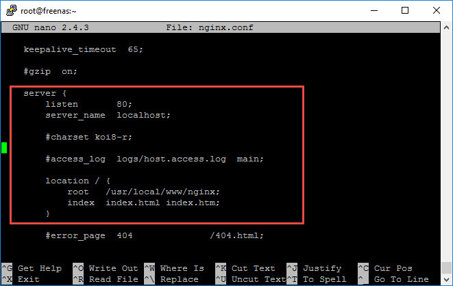

I’m try to follow a tutorial Install Guide: FreeNAS (FreeBSD) and I’m have trouble with a section of the tutorial. I hope this is the correct place to ask if not, I would appreciate a better posting location suggestion.
nano nginx.conf # remove server segment and replace with include nzedb.conf;

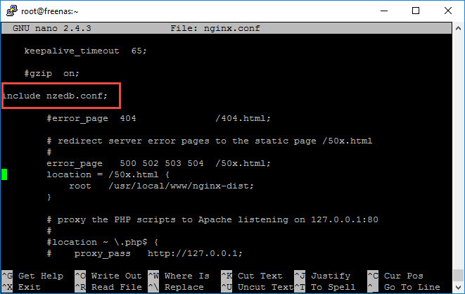

to this
and service nginx restart gives this error
any ideas on what I’m doing incorrectly?
Wizened Sage
12,439
If I had to guess (and it's only a wild guess), nano is wrapping lines and causing problems. Try deleting nzedb.conf, and creating it again, giving the -w flag to nano: 'nano -w nzedb.conf'.
Joshua Parker Ruehlig
Wizened Sage
Dec 5, 2011
5,946
search for the word "change" in your nzedb.conf. It somehow got inserted in there.
