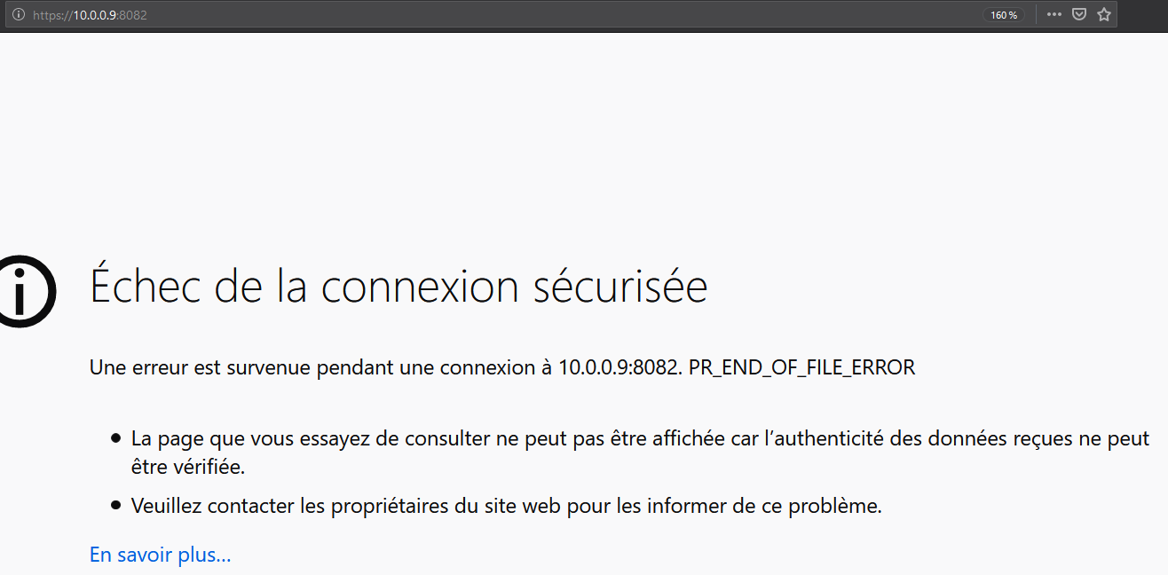

As I had no answer, I decided to go along with the FreeBSD Jail. Everthing seems fine until I try to access the server. I get this error message.
Any idea how to solve that. Firefox help doesn't show any way around.

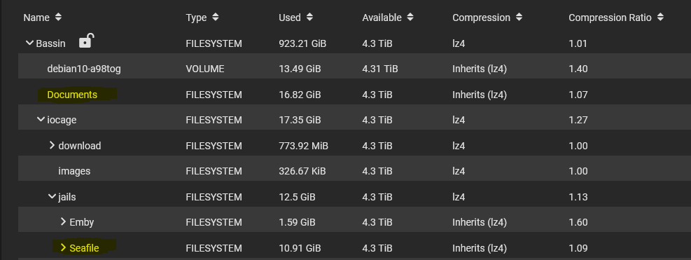

After creating the Jail, should one use "Mountpoints of Jail" or the data stays under Iocage ?
I want to sync "My documents" on Windows using Seafile.
I would like those files to Backup to Backblaze B2. It would be easier if the files were in a dataset "Documents" rather than in the jail.
