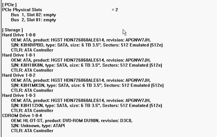

@Chris Moore My apologies. I read a lot of the documentation on the FreeNAS and the site but missed some of the details. I am new to a FreeNAS build and new to the server world. Sometimes I don't quite understand all the information that's necessary for you all to help me troubleshoot.
All HDD's are connected to the system board. Dell has prewired 4 drives marked HDD0, HDD1. HDD2, and HDD3. I've attached a snapshot of the last system test I did for what it's worth. The drives are brand new out of box and so the issue discussed by @Apollo should not be present here. I can confirm it is in ACHI mode. I don't have a RAID controller on the server so I don't think that would be an issue here.

Here is some additional information from the IDRAC information:

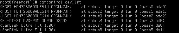

I feel like I am blowing up my own feed but trying to provide as much info as possible. I've unplugged and plugged back in all the drives, played with the embedded controller, etc. and still no avail. I ran a camcontrol devlist in FreeNAS and have attached the result. Note that the two USB drives are there for the boot device and I was going to create a backup boot drive as well (Potentially). Is there any way to distinguish between this result and what specific drive isn't showing up in FreeNAS?
@Chris Moore , I did look into the Power Disable function you mentioned above. I do not have the 3.3v issue described so don't think that is contributing.

Ralph, I am unfamiliar with Ispci -v (I tried it in shell and it didn't work), I did run "dmesg | grep SATA" and it only found 3 SATA drives. ada0, ada1, and ada2.
