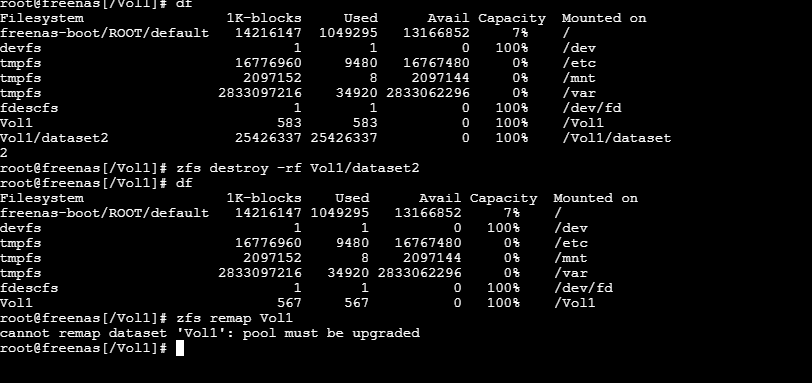

If you're sure you've offloaded dataset2, then you can zfs destroy -rf Vol1/dataset2. This should free up a good chunk of space, and allow you to set the mountpoint option for dataset1.
Please don't use USB for VDEVs. USB controllers can't really handle the usage patterns of ZFS. They're really only capable of dealing with FAT32 partitions.
Hi
Will the command zfs destroy -rf Vol1/dataset2 also destroy the mount point under /Vol ?
I'm just asking because if it does destroy the mountpoint, i may not be able to create it again since there is no space (assuming the worst case scenario does not free up the space when destroying the dataset).
I am positive I have saved all of the dataset2 data.
many thanks
Yes. If you're concerned this may not free up space on Vol1, you can run zfs remap Vol1 to kick off a scan for free space, which should be available after the dataset2 destroy. Then try zfs get mountpoint Vol1/dataset1. This should be set to /mnt/Vol1/dataset1. If it is, then try zfs mount Vol1/dataset1.

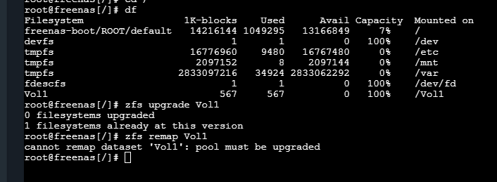

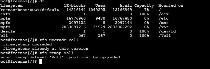

Hi
I have now destroyed dataset2 (26GB)
However I got an error when trying to run the remap command.
I know that file deletes happen asyncronously. Should I way for a while to see if the space is reclaimed or is there anything else I can do.
Do I need to "upgrade" the volume first ?
Thanks.
Samuel Tai
Apr 24, 2020
5,399
Yes, please run zfs upgrade Vol1 and then the remap.
Samuel Tai
Apr 24, 2020
5,399
Sorry, I meant zpool upgrade Vol1.

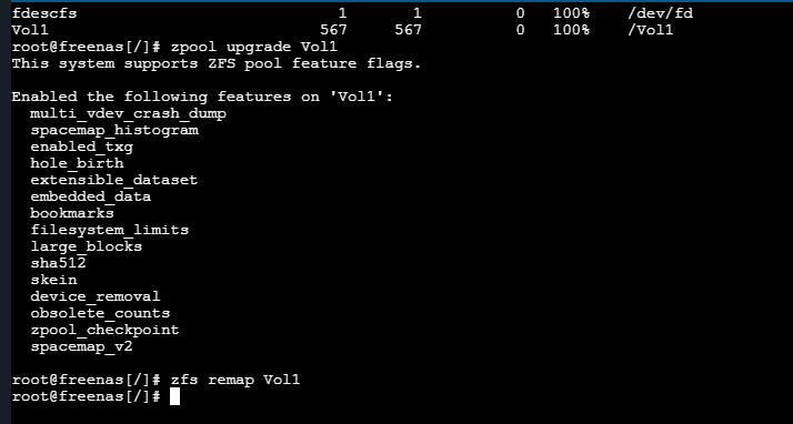

lessdrama
Aug 3, 2020
21

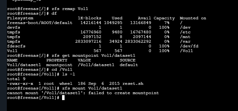

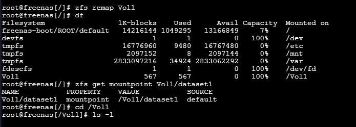

Hi No problem. I appreciate all the help.
The upgrade worked successfully and I have started the remap

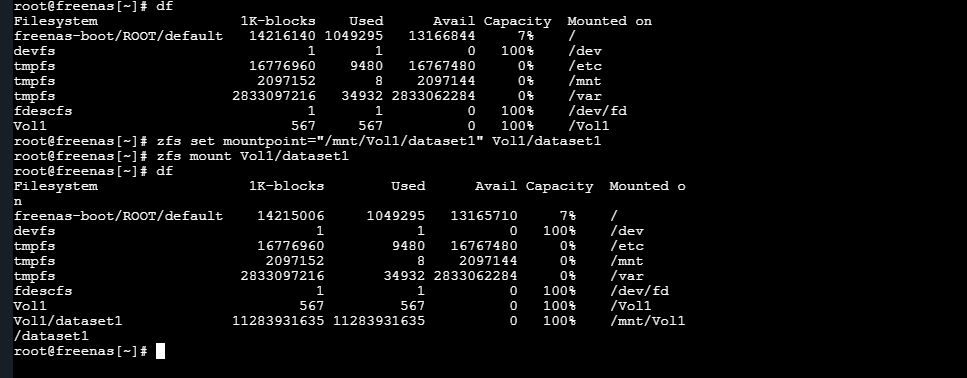

No change yet though to the free space and so I cant mount the dataset1
Many Thx
Samuel Tai
Apr 24, 2020
5,399
That's the wrong mountpoint. Try zfs set mountpoint="/mnt/Vol1/dataset1" Vol1/dataset1. Then try the mount again.

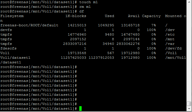

lessdrama
Aug 3, 2020
21
You Sir are a genius :)
At least I can now copy all of the data off onto the new NAS.
If you have any ideas about reducing the space (because just removing the files does not help), then it would be appreciated.
Many Thanks.

Hi
I dont believe I have any snapshots of this volume as I had to install freenas 11 due to the corruption of the freenas 9 usb stick and I had not setup any snapshots.
However - big news.
I deleted a few large files just using the rm method and I can see that the amount of used space was going down but the free space was still zero.
I ran the remap command again and checked again AND I NOW HAVE SOME FREE SPACE :)
I will now copy the data off and then delete to get down to the 80% level.
This forum is awesome - Thank you all so much.

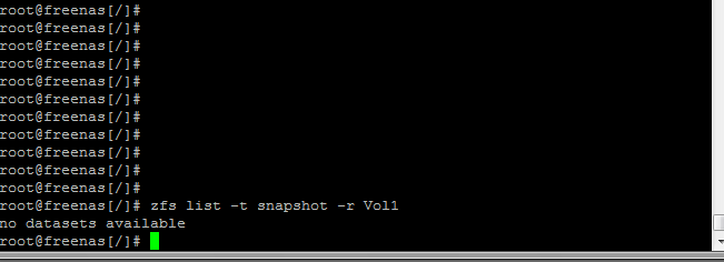

Snapshots are part of the volume.
Out of curiosity, what does the following command returns?
zfs list -t snapshot -r Vol1
From you original post, it seems you have "Compression" set to "OFF". I would suggest enabling LZ4 compression has it should help you with the space issue to some extent.

Hi
it says no datasets available (and I did not delete any snapshots during this problem)
Apollo
Jun 13, 2013
1,458
Hi
I can confirm running the command on a volume or dataset that doesn't contains snapshot will return the "no datasets available" message.
So to summarize, you don't have any snapshots.
This also means deleting files will allow recovery of the allocated space. When space is recovered form deleting snapshots, it sometimes takes a while (several minutes) from the space to be entirely freed. Maybe this is the same type of behavior here.

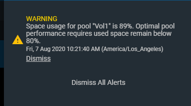

I have now trimmed the Volume size down to 89%. and have a popup on the GUI reminding me that optimal is to be below 80%.
Is this is the case on large volumes (18TB RAIDZ2 12TB usable)
Many Thx.
Yorick
Nov 4, 2018
1,912
The warning is because performance gets increasingly worse around 80% full (not to say it doesn’t degrade earlier, it does) as ZFS starts running out of room for sequential writes. You may get a little further with very large pools, and, really, once you are at 80% you’re so full you want to do something about it. I doubled my pool space when I hit 75%.
