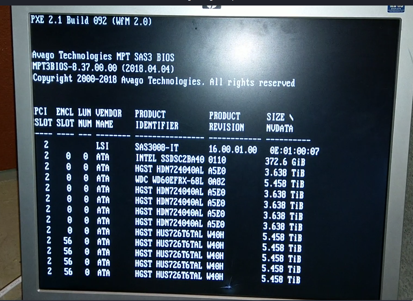

LSI Boot message:

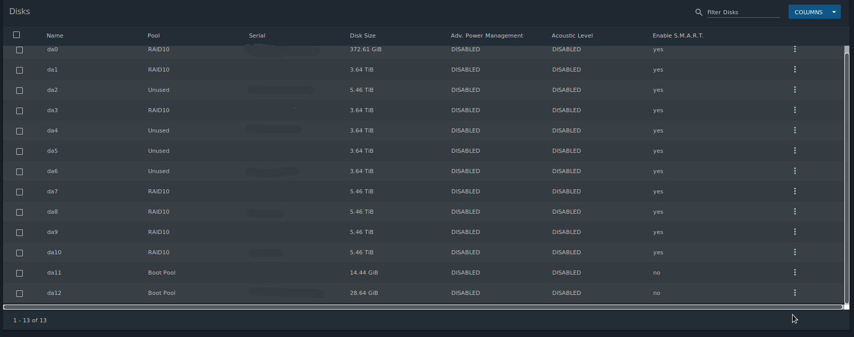

FreeNAS drives:
Screenshot from 2019-01-29 22:13:50.png
The new drives are 5 X HGST 6 TB (da7 -10) + 1 X WDC 6 TB (da2), yet I can only see 4 X HGST 6 TB in FreeNAS, where is the last one?
If you are confused by the odd number of drives, I used the WDC 6 TB (da2) to replace one of the old 4 TB drives, did a reboot after that as well.

Yesterday I did a reboot of the server, noticed that one of the disks wasn't active when POSTing, so I swapped places for a drive known to be working with the faulty one, rebooted again and - success, now all the drives are presented to FreeNAS.
It was probably my fault all the time not checking if all the disks where active during the POST.
